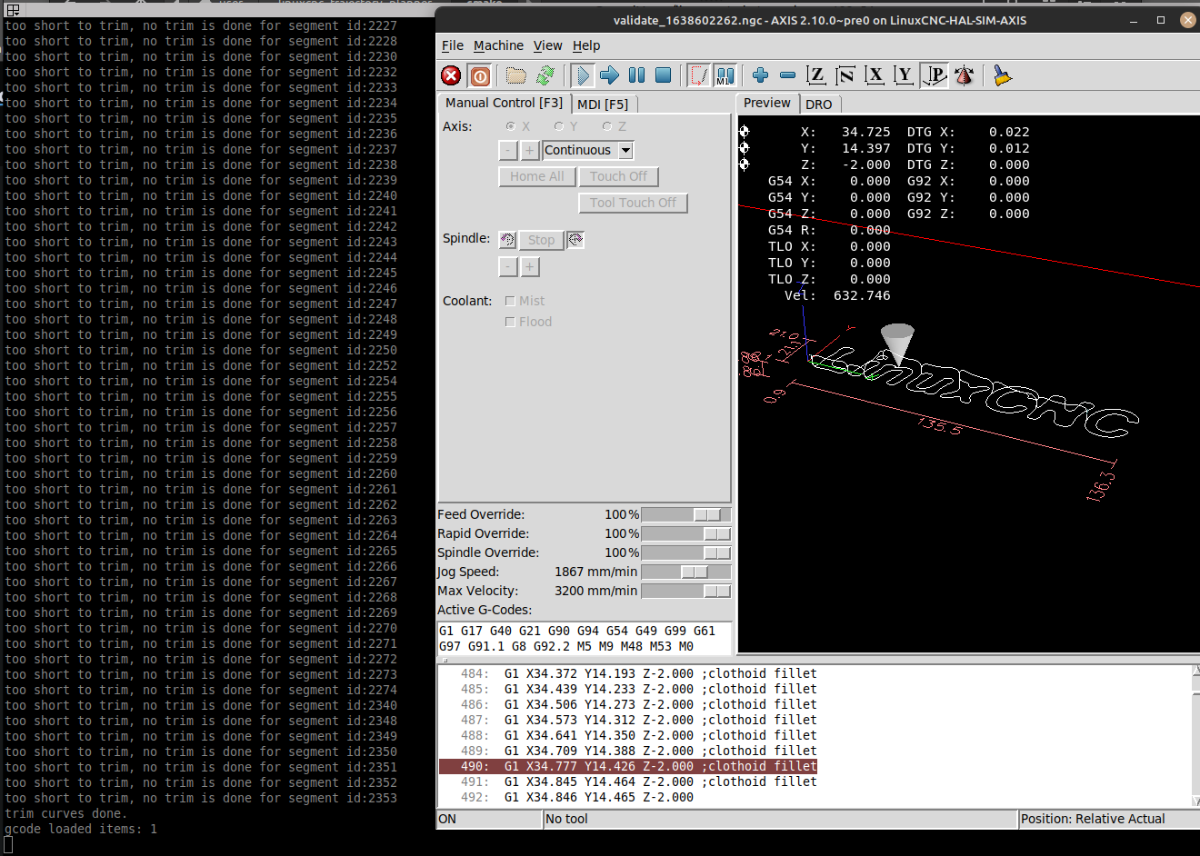

21 Oct 2024 07:25 #312737 by Aciera
Replied by Aciera on topic linuxcnc trajectory planner
Ok, so just so we are on the same page, here is what I get.
It creates the validate_<...>.ngc :
gcode loaded items: 1
gcode loaded items: 44
gcode loaded items: 135
gcode ready to be processed in thread.
set your gui maxvel to zero. Then the machine won't move when saving the gcode.
init curves done.
trim curves done.
added inbetween segments:178
Gcode file ready, filename:../../../cmake/validate_1048567314.ngc
thread completed.
vector pointer is not valid.
Not sure if 'vector pointer is not valid' is a problem but I notice that when I run the created file it gets hung up after having run the first maybe 500 lines (this changes from one try to another). At this point linuxcnc cannot be recovered and has to be restarted.

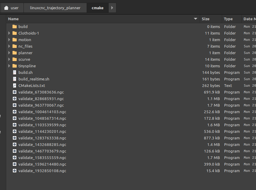

Meanwhile more validate_<...>.ngc files have been created:
Are you seeing these hangups as well?

21 Oct 2024 11:49 #312774 by Grotius
Replied by Grotius on topic linuxcnc trajectory planner
Hi Arciera,
Yes once you pressed the run button it optimizes in the background.
Once you see terminal output: file created, you are ready to load the result file "validation_xx.ngc".
If you have the validation file loaded and press run again, it optimzes the validation file.
In theory this should not fail. But i have seen it can fail. So why it should fail i don't know yet.
Have to figur out this.
The pointer is not valid, is a message that the memory is released for the entire operation. This is good.
Looks cool.
Yeah. looks cool. You can write down any bug's related to the algo. For example lines over lines. Are there exceptions to make?
Testing is welcome.
So are you thinking of moving on to the planner now or are you still thinking about representing the clothoid fillets in a more concise form rather than a bunch of G1 line segments?
Before moving to the planner, testing the scurve algo is now in progress for 2 day's. I had some problems today. So it can take a while.
When we have ready :
1. Filletizer
2. Scurve
Then we move to the trajectory planner itself. In this planner clothoid's are represented by only 2 points and 4 double values.
So the clothoid linestrips as you see now, are just for representation, validation. In the planner you won't see them anymore.
