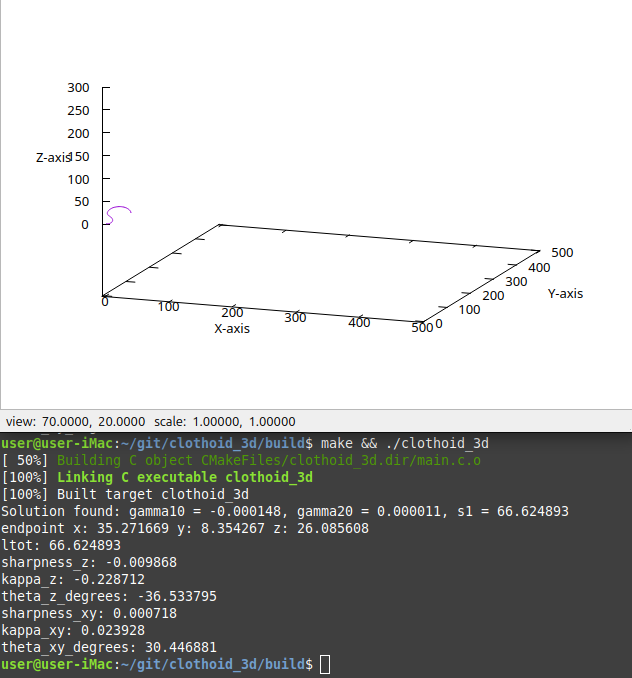

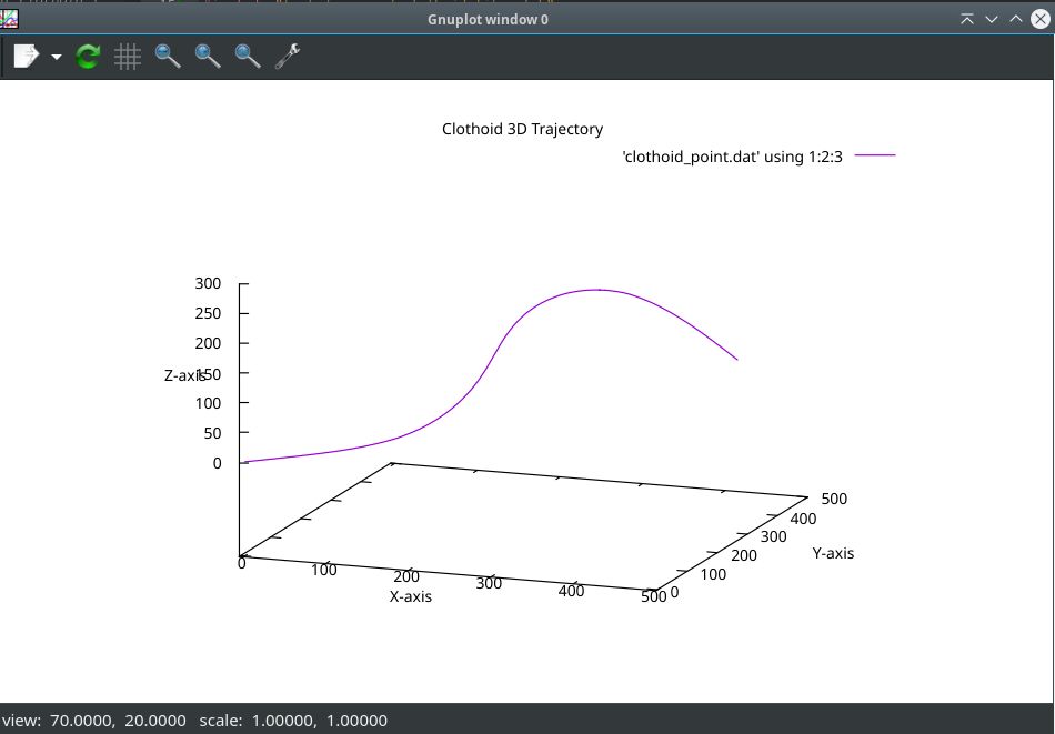

20 Feb 2025 13:14 #322060 by Aciera
Replied by Aciera on topic scurve trajectory planner
So the gamma11 and gamma21 depend on the start values, however there is another problem.
I'm running single_clothoid_fit and I changed kappa10 from 0 to 0.1 and now everything is off:

20 Feb 2025 13:23 #322062 by Grotius
Replied by Grotius on topic scurve trajectory planner
@Arciera,
I found the buggybug. . Was not alien obstruction.
Glad in eq14 we can choose 2 interpolation models:
1. eq14_drift (archived)
2. eq14_gauss
It turns out nr. 1 works good and shows correct clothoid compound.
So nr.2 contains a buggybug. Will try to find it now.

20 Feb 2025 13:30 #322063 by Grotius
@Arciera,
Yes, kappa10 is start curvature in z direction.
Gamma11 = y11, is the rigid property of the clothoid. if 0, then straight line. When 0.001 then clothoid begins to curve in a direction depending the sign off y11.
Keep also an eye on the GNU plot display max values. "set xrange [-20:80]\n"
The following user(s) said Thank You: akb1212, Aciera

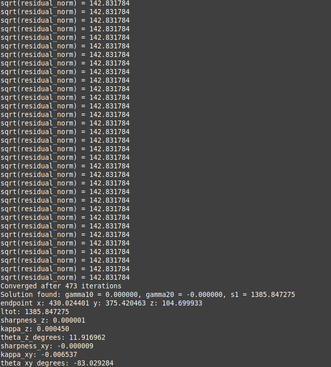

20 Feb 2025 13:46 - 20 Feb 2025 14:01 #322065 by Aciera
We also might want to call it a fail if max_iterations have been reached:
Solution found after 1000000 iterations: gamma10 = -0.000148, gamma20 = 0.000011, s1 = 66.624893
Strange that it thinks it has succeeded when the residual is still way off (looks like its happy to have found a local minimum or something):
Last edit: 20 Feb 2025 14:01 by Aciera.

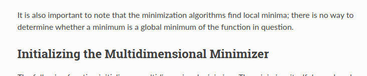

20 Feb 2025 14:25 #322071 by Aciera
reading this might explain why it is returning a local minimum:
www.gnu.org/software/gsl/doc/html/multimin.html
So in my opinion we are using the wrong solver.
The following user(s) said Thank You: akb1212, Grotius

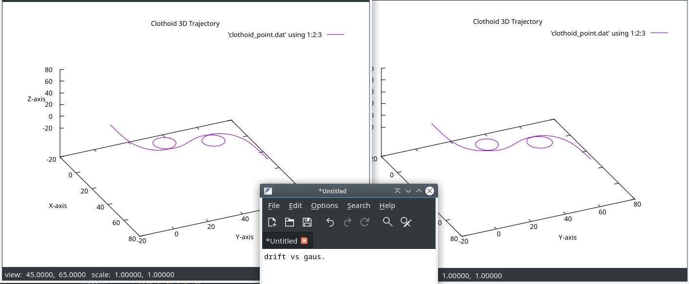

20 Feb 2025 15:02 #322075 by Grotius
Hi Arciera,
Haha yes indeed we now use : Nelder-Mead simplex method
For now this solver prooved our codebase works ok.
Maybe we can switch solvers with a flag.
Then we can also measure different solvers performance time and choose the best one.
We will add a new dogleg solver soon, as libdogleg was kind of problematic. Github repository
also say's better to use seres solver.
The gauss now works without junction flaws, error solved in eq14_gauss.
It was kind off trickie error. It needed the theta, kappa, sharpness at the given distance.
This in combination with the gauss method, is tricky.
Result:
The drift vs gauss function in the example without fit method:
github updated
