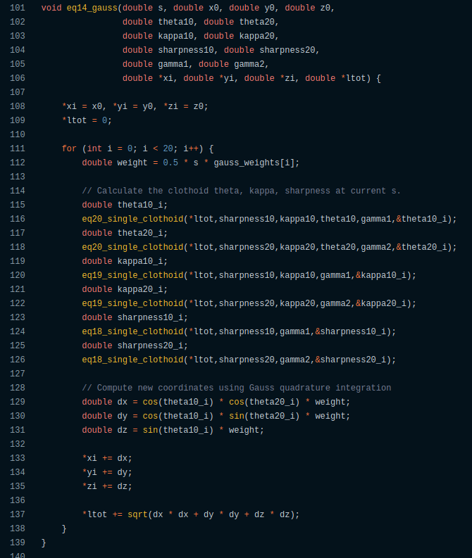

Something like this:
// Calculate the clothoid theta, kappa, sharpness at current s.
double sharpness10_i;
eq18_single_clothoid(0,sharpness10,gamma1,&sharpness10_i);
double sharpness20_i;
eq18_single_clothoid(0,sharpness20,gamma2,&sharpness20_i);
double kappa10_i;
eq19_single_clothoid(0,sharpness10_i,kappa10_i,gamma1,&kappa10_i);
double kappa20_i;
eq19_single_clothoid(0,sharpness20_i,kappa20_i,gamma2,&kappa20_i);
double theta10_i;
eq20_single_clothoid(0,sharpness10_i,kappa10_i,theta10,gamma1,&theta10_i);
double theta20_i;
eq20_single_clothoid(0,sharpness20_i,kappa20_i,theta20,gamma2,&theta20_i);

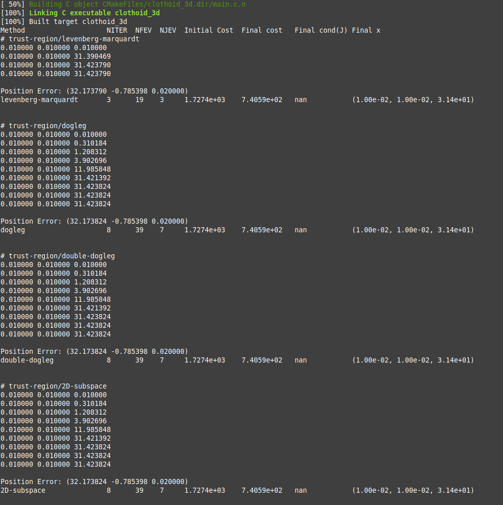

Here is my failed attempt:

The idea was to calculate the elements of the Jacobian numerically but it fails miserably:

@Arciera,
Indeed. Good spot !!!
I was thinking about the 3d fitting between gcode segments.
Do we really need the transformation, and then do the fitting in a null plane?
This was needed for a 2d clothoid, when used in a 3d plane. But for this i think
we don't needed, unless there is something i forgot.
I thought maybe we can just fit the clothoids in 3d space.

I see you have splitted up the gaus interpolation into x, y, z.

as used in the abstract?
We have already a case where the helix tail or start from a G2, G3 is used as end vector.
Edit:
Did a mayor update on the infrastructure.
- Use struct for clothoid data.
- Use seperate plot function.
- Use enum to choose a solver from the list.
- Use a central residual function used by all solvers. Where the objective function can cast types.

21 Feb 2025 13:16 - 21 Feb 2025 13:43 #322202
Well that's just a rough hack really that would need some streamlining but as long as nothing converges there is no point in polishing.
[edit]
And it looks like I have done it wrong having set ltot to 0

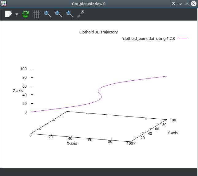

@Arciera,
The only motivation in the abstract is to align the normal n with the positive z axis direction.
The equatations for the math are already there.
- Added clothoid interpolation
- Added dynamic plot size
@Fabian,
looks like you are making good progress.
Yes. To be honest. I did not know we could do this at all. My math level is not that good.
The progress is fenominal. We now have at least a working solution.
We can now refine, polish code and add different solvers to the codebase. Arciera is hard
working to try out new non-linear solvers, wich are kind off trickie to set up.
The result is a G3 solution between previous and next gcode segment.
Indeed, it matches curvature.
Later on we can test more graphical in opencascade. Wich has also a great codebase
to do forward & inverse transformations.
And maybe, maybe i will code a bi-clothoid in the future. As a 4-clothoid can cause overfitting,
wich is inherent to higher degree curves.
