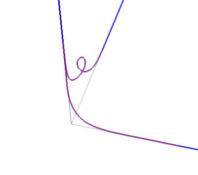

What exactly do you mean by 'overfitting'?
Replied by Aciera on topic linuxcnc scurve motion planner
I have seen cases where the clothoid fit result looks like overfitting.
- ihavenofish
- Posts: 816
- Thank you received: 176
19 Mar 2025 05:07 #324262
by ihavenofish
Replied by ihavenofish on topic linuxcnc scurve motion planner
i assume he means the overshooting on the lower right in the last image.

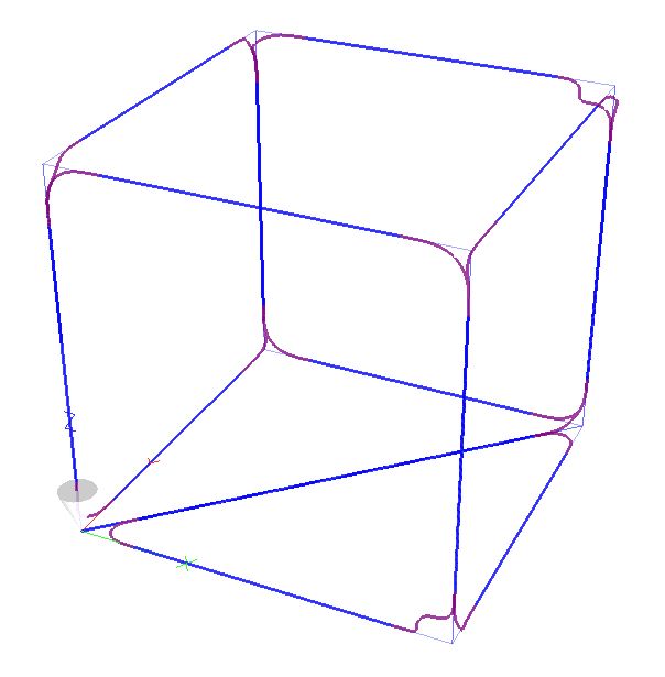

- Posts: 4316
- Thank you received: 1916
19 Mar 2025 09:24 - 19 Mar 2025 09:28 #324272
Ah yes I have noticed those. Seems to me that it does not occur for fillets in the XY plane.
[edit]
which makes me think, are you still transforming the space corner to the XY plane to fit the clothoid as in the paper or are you skipping that step (as I believe you wanted to at some point). If you are fitting directly in 3d than that may have something to do with it.
[edit]

19 Mar 2025 10:31 #324280
by Grotius
Replied by Grotius on topic scurve trajectory planner
@Arciera,
The abstract proposes forward transformation (projection) to the xz plane.
Indeed the problem does not arise when there is no z value.
And yes we are directly fitting in 3d space.
The problem isn't there, when you do a plane fit. This is in fact a 2d fit solution in 3d space,
including forward & inverse transformation steps. We did this using the 2d clothoid lib in our
previous planners.
Maybe we can think about this problem and how to solve it using a 3d space fit.
You can state that this is a clothoid wich makes a full torsion turn, wich has no reason to do so.
The clothoid3d uses a non-linear solver to find the xyz endpos for the clothoid fit.
The solver will iterate to the desired endpoint in shortest way, naturally.
It's very unlikely for the ceres solver to give us a self intersecting result as shown in your picture,
unless we give incorrect input angles.
And it's unlikely we have infinite solutions regarding the 4-clothoid-spline fit.
The codebase ruled out self intersecting clohoids by making improvements to the abstract: Abstract bug fixes
previous planners.
- I think the ceres is giving it a initial torsion value, and goes on with the torsion during fit iterations until a endpoint fit is found.
- Why does it use this full torsion only in certain space corner directions? Is there a reason we don't know yet?
- In eq45, page 7, the Delta Theta is calculated by: Thetai4 - Thetai0.
The clothoid Delta Theta produced by this substraction, is not alway's correct.
When the incorrect value is used, it shows a self intersecting clothoid. Eq.45 input Angles are in the range [0,-2pi], [0,2pi]. Substraction can lead to a incorrect
Delta Theta. To solve this issue, we convert back the thetai[x] into a xy vector.
From here the signed angle between 2 vectors is calculated.
This ensures a correct Delta Theta value. Problably this is also the reason why in the abstract forward & inverse transformations are used.
In this codebase forward & inverse transformations are obsolet

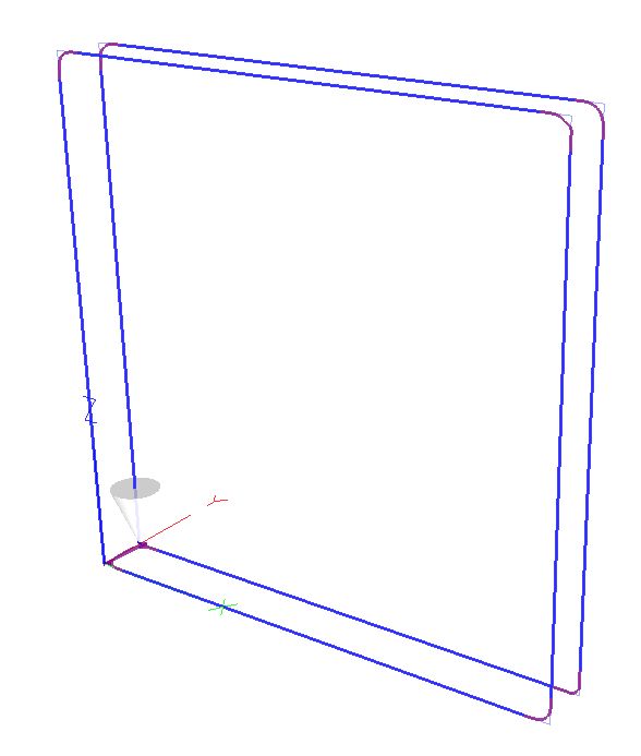

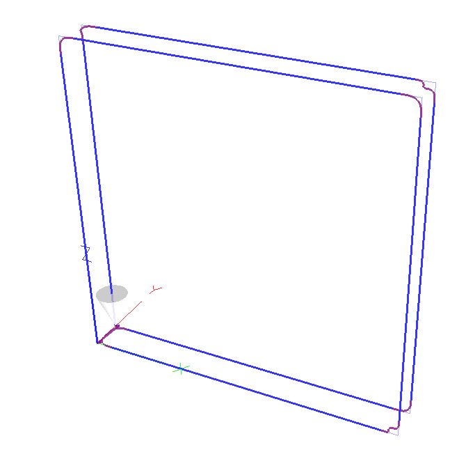

- Grotius
- Posts: 2401
- Thank you received: 2312
19 Mar 2025 13:28 - 19 Mar 2025 13:32 #324293
by Grotius
@Arciera,
Attached a gcode sample. A cw and a ccw square. That contains the problem.
Extra torsion turn:
No extra torsion turn:
The investegation, i printed the clothoid result and take a look at the theta values, and compared them :
** where != means is not.
If clothoid output is like this, fit is ok:
you can introduce a tiny error to get the fit off-plane. A off plane fit seems to solves this issue.
So when you add 1e-6 (ultra tiny error) to one off the trimmed line's z-position, it goes off plane. Problem is solved.
So when lines have no intersection, there is no extra torsion turn.
Now i did not test any further. So i hope this is it.
Extra torsion turn:
- theta10 Z != 0
- theta 20 XY = 0
- theta 14 Z = 0
- theta 24 XY = 0
- theta10 Z != 0
- theta 20 XY = 0
- theta 14 Z = 0
- theta 24 XY != 0
