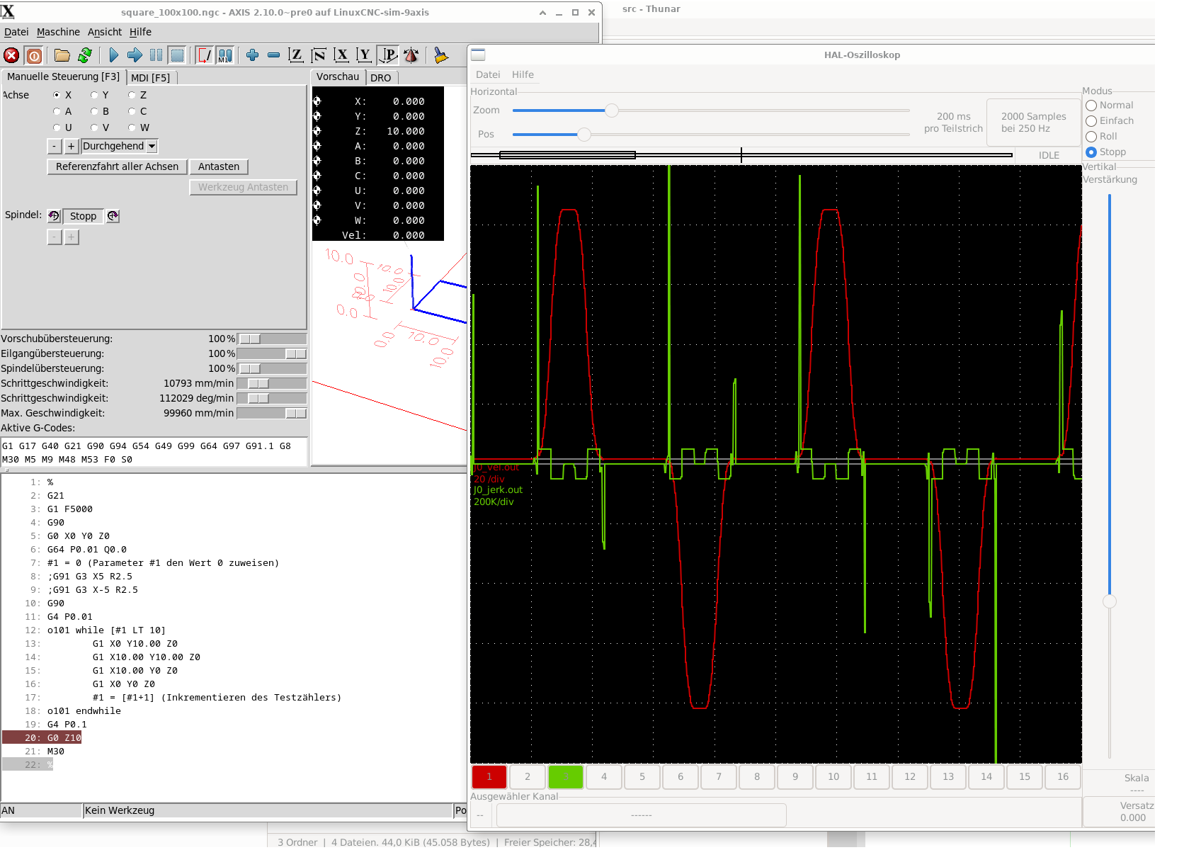

Hi Ruediger,
We are aware of spikes. Haha.
Even the most elegant curve seems to show acceleration spikes in halscope.
I dont have the J0 jerk pin here in my axis config.
One way to rule out spikes is to introduce back-end runners. They will filter out all spikes.

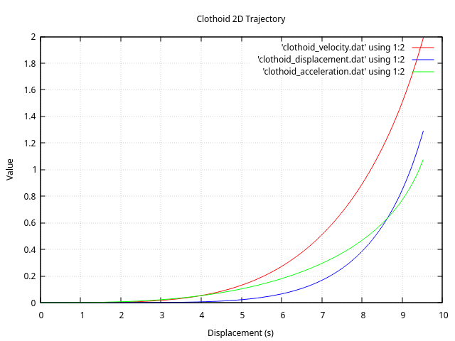

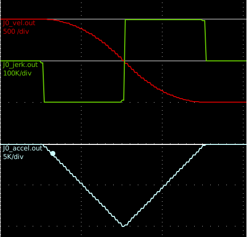

Hello,
attached is the hal file with the jerk pins.
Gruß Rüdiger
Gruß Rüdiger

@ Rüdiger,
Max acc scurve = 2 x acc.
at scurve inflection point the
Scurve acc = 2 x acc.
see scurve lib abstract.

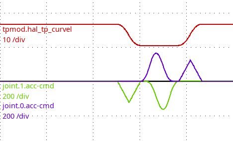

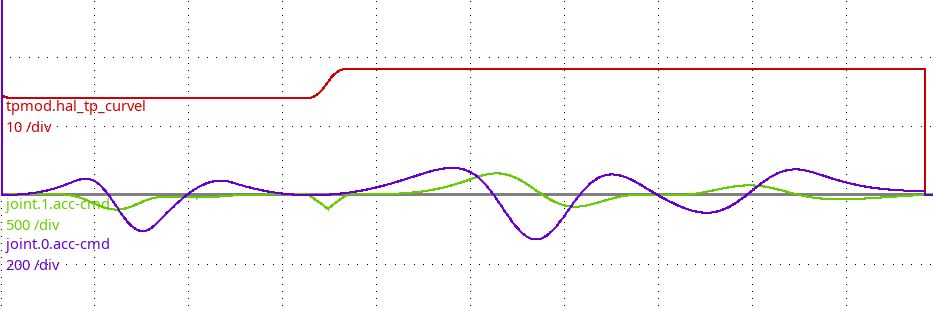

Hi all,
Today was a lucky day. We managed to fix acceleration spikes at the 4-clothoid-spline junctions.
The problem was solved by using a new gauss legendre and minor function updates to the clothoid3d lib.
The iteration for gaussian legendre is now set for a 16 for loop.
We can expand to 32 or 64 loops to even increase accuracy.
Now i changed the back color off halscope to plot a white background as this is nicer for websites and documents
to show pictures.
Below are some halscope results, where motion is passing trough 3d-clothoids. The acceleration spikes on
joint 0 & 1 are gone. This tells us the interpolation off the clothoid is now absolute. And without any numerical errors.
So now the clothoid interpolates just as a line or arc.
This was really a bad situation. Wich is now solved.
Git is updated.

Today i started investegating something new. experimental code
The question is, can we use a clothoid curve for motion, just like the scurve is a curve used for motion?
The idea came up a while ago. Scurve motion uses derivates, the clothoid also uses derivates.
Somehow i used the clothoid curve for the velocity profile.
The theta start of the clothoid curve is a vector, this can be transformed to acceleration start and visa versa.
1. The x axis of the clothoid is then time.
2. The y axis of the clothoid is then velocity.
During the curve's velocity profile, we printed the acceleration values along the curve. What i didn't know is,
the acceleration profile is not a straight line as like the trapezium or scurve motion profile.
Here is a plot of acceleration stage, mention the acceleration line. It's curved. This involves less Jerk?
Thanks!
