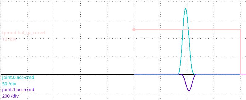

Hi Arciera,
Thanks for feedback.
If the acc in the ini file is 50, the scurve is max 2*50=100 at inflection point. This is normal.
However. I run the same file, and i got no spikes.
This is the first corner :
Maybe you did not update the clothoid lib? U used clone recursive wich is needed.
Or git is messed up.
For sure i just did a push for scurve planner, clothoid lib, scurve as up to date.
That's annoying when you have 3 repository's depending on each other.

But the acc-cmd value reaches ~180?
[edit]
I did do a 'git pull' and reran './installer' but I can check again tomorrow.
Replied by Aciera on topic scurve trajectory planner
[edit]

Hi Arciera,
The scurve planner takes the [TRAJ] trajectory acceleration : MAX_LINEAR_ACCELERATION = 200
When tpAddLine, tpAddCircle is done, it gives this 200 value to the planner.
The scurve acceleration max is then 2*200=400 at inflection point.
However the planner does not lower the acceleration to a specifik max joint acceleration at the moment.
We have acces to all joint max acceleration values.
We could reduce max acceleration to satisfy max joint acc. We implement this without any problems.
