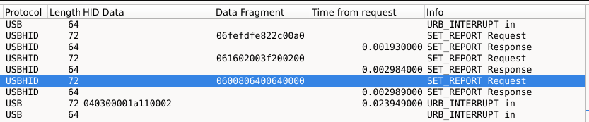

I think the data looks okay for you Hannes, and it seems likely that the firmware on your pendant doesn't support the F/S indications. I am not setup to build linuxcnc on this machine right now, but here is a screenshot from Wireshark showing the same type of data as your terminal output:
The highlighted line is the last part of the report, where the feed and spindle overrides are given. For me, both were at 100% = hex 0x64. My pendant also shows the F/S values in auto mode when a program is running. Many different firmware variants, I suppose...
I've had LinuxCNC simulation running a long G-code program a couple of nights to see if I can find some issues with my dongle firmware. So far, no disconnects nor any other meaningful issues. Sometimes (around 0.0035% of the time) it send a zero-length package, which is not correct, but neither is it harmful. I will try to look over the USB handling to see if I can get rid of that one.

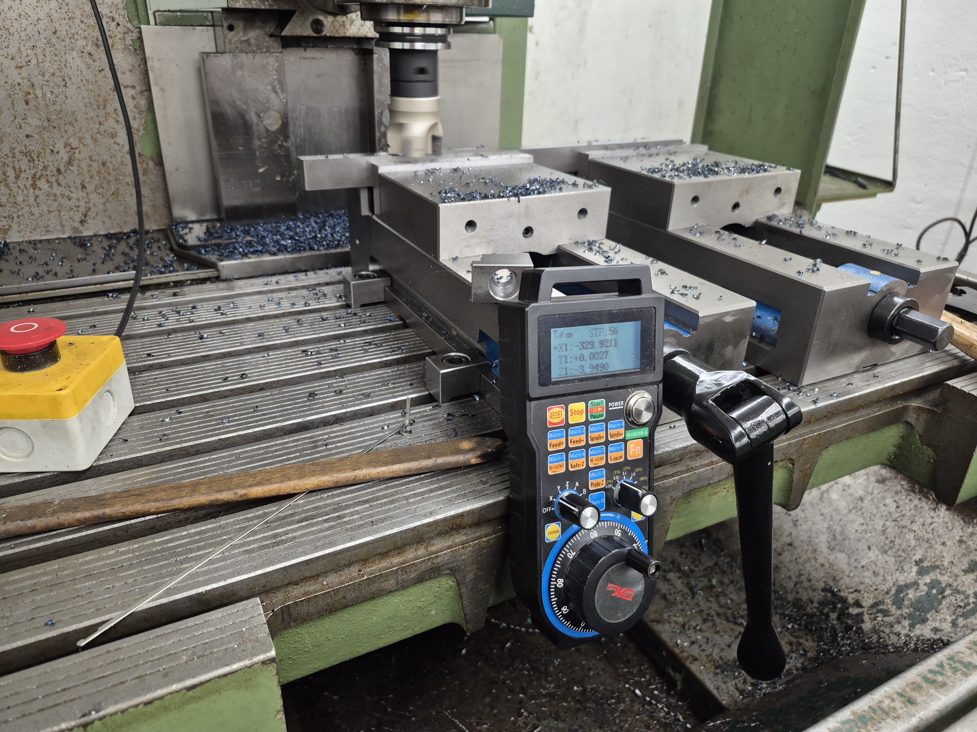

- Hakan
- Posts: 1343
- Thank you received: 497
28 Feb 2026 14:20 #343666
by Hakan
Replied by Hakan on topic XHC WHB04B development?
Still trying to learn exactly where in the code it fails.
It doesn't reconnect, that's for sure. If it had, it wouldn't have been an issue.
I overwrite the log and, alas, no saved useful log.
"Unfortunately" I didn't get a crash today when I worked with the machine.
I like the whb04b a lot.It's worth spending some time improving stability.
The following user(s) said Thank You: NWE
