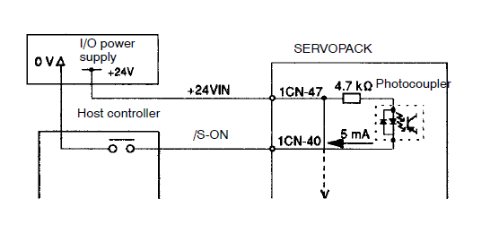

Ok so maybe I have an issue with my wiring.....I am trying to duplicate the wiring from the original spec but using the I/Os on the 7i77. With servo on and enabled I disconnected the analog out completely but still get the creep. I do question the original wiring from the manufacturer as they have the wiring reversed for the /SON circuit.. I attached the schematic of the /SON circuit from Yaskawa. Let me know. Thanks.

On your drawing, is ENA0+ connected to ICN-40 and ENA0- connected to 0V?
( That would be the correct wiring for a active low enable )
If you disconnect ICN40 is the drive disabled? (creeps stops and motor shaft turns freely by hand )

Now I seem to get nothing. 0V can be sourced from where? I take it I can not use the field voltage ground as 0V? Thanks Peter always a great help.

If ICN-47 comes from field +24V then yes ENA- goes to field gnd

Ok wired to what we discussed now I am back to beginning issue of axis creep, yes P value is at 0. I am confused as to why it still creeps even if I disconnect the velocity reference? Thanks Peter!
