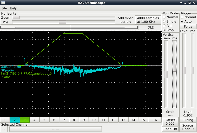

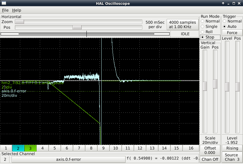

07 Jun 2015 00:47 #59540
by pmcstoneinc
Replied by pmcstoneinc on topic 7i92/7i77 Yaskawa Servo
See attached, first is at a velocity of 33,000mm/min, second is at 40,000mm/min. Let me know. Thanks
Dan
Dan

07 Jun 2015 01:00 - 07 Jun 2015 01:04 #59542
Replied by PCW on topic 7i92/7i77 Yaskawa Servo
Looks like either a drive fault or you have exceeded the maximum encoder count rate.
If you are limited by the encoder count rate you can try turning off the encoder filters
by changing:
hm2_7i92.0.encoder.00.filter 1
hm2_7i92.0.encoder.01.filter 1
hm2_7i92.0.encoder.02.filter 1
to:
hm2_7i92.0.encoder.00.filter 0
hm2_7i92.0.encoder.01.filter 0
hm2_7i92.0.encoder.02.filter 0
In the HAL file
I would not do this unless you are using differential encoder signaling...

07 Jun 2015 01:11 #59543
by pmcstoneinc
Yes they are differential signals.
Thank you! Removing the filtering resolved the issue.
