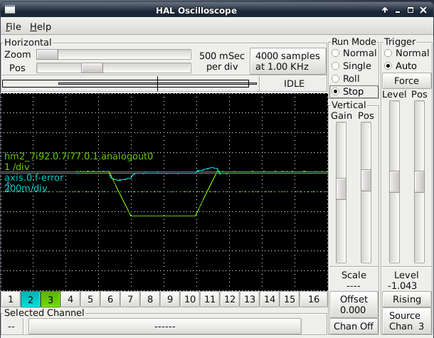

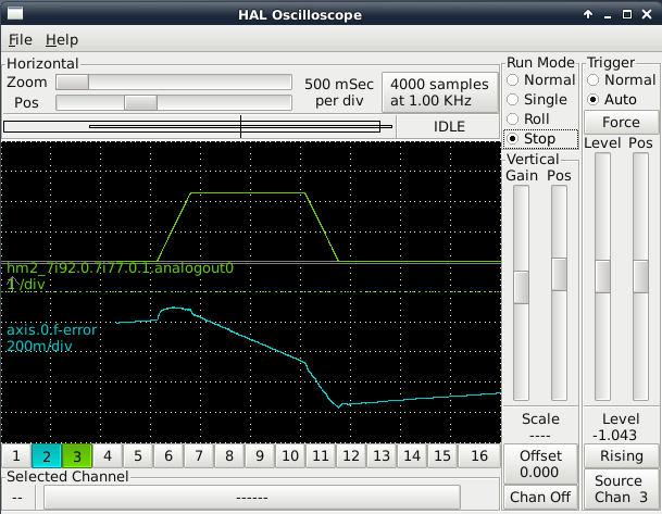

So I am getting ferror with a trail off (see attached), this only happens in the negative direction of the axis.

can you post your _current_ hal and ini files?
looks like a hal or hardware problem

in the hal file, remove these lines
setp pid.x.maxerror .0005
setp pid.y.maxerror .0005
setp pid.z.maxerror .0005
In the ini file the y output scale is 1 instead of 10 plus the
FF1 value probably needs setting as well
(FF1 can be fine tuned more easily if P is temporarily set quite low)
FF2 is used to get rid of the bumps during accel and deccel

Sorry forgot to mention I am only working with the X axis currently. The scope images were of the X in both directions, just questioning why the difference in the positive direction? Let me know your thoughts on the positive direction, again its only on the decel of the analog out. Thanks
Dan

The problem is the
line
Edit:
This handicaps the P (proportional) part of the PID loop to only allow velocity corrections of
.0005 *10 = 5 mV maximum change in the output voltage on top of the output controlled by the FF1 term
Its actually rather amazing that it works at all and shows that FF1 is quite close
(since FF1 is doing pretty much 99.8% of the work)
The difference between directions is probably due to a few mv offset in the drive and 7I77 output
line
Edit:
