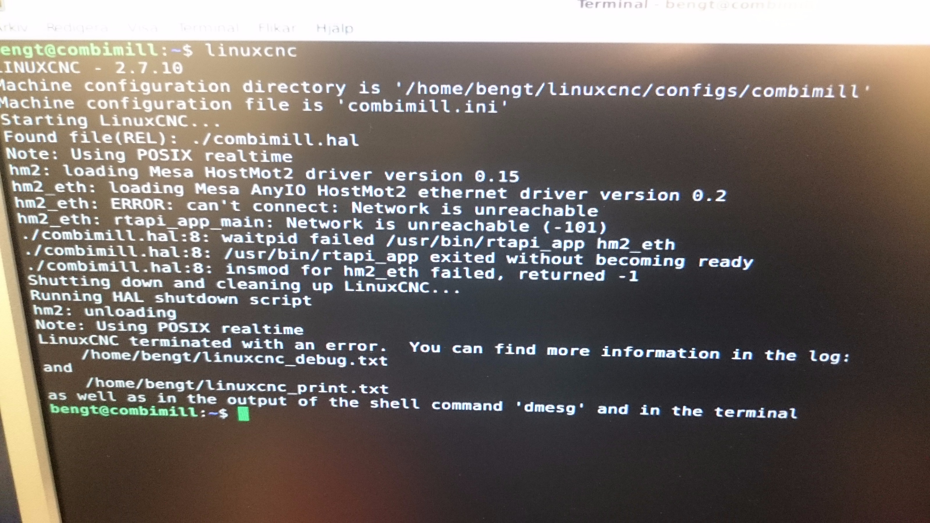

Have followed the fine document Norbert has written, but still I cannot get ETH connection 10.10.10.10 W3 UP still reports network error.
All LED's on board as per the manual, network cable controlled = OK
Having issues with my network down to the workshop so I have to walk up and down to read write these messages. Will try to solve the issues so life will be much easier. My Devolo adapters (ethernet over powergrid) are behaving badly suddenly and used to work reasonably before.
Any suggestions what to try next?

There must be something odd with the Ethernet driver as I am having problems with 3 different PC's and none of these will accept eth connection, Tested now with my ElitBeook 8440P and it also behaves like this, WiFi works OK down here in the workshop.
But no go with 10.10.10.10 on the 7i76E board. So my conclusion is something odd with driver for eth.

Well looks like Ive been barking on the wrong tree
After several tries I managed to tie the PC to be 10.10.10.11 and now it is alive but with errors of course like limit switch on joints 0 1 and 2.
More to play with tomorrow.
Cheers
Bengt
Cheers
Bengt

26 Jul 2017 22:08 #96529
Replied by rodw on topic Help needed to get my 7i76E + 7i85S + 7i73 on my mill going.
Make sure the 7i76e is powered up before booting your machine. If in doubt see if you can ping the ip address. I have found sometimes that the network needs to be restarted so I have written a little script to do that on Linux Mint as it was a bit trickier than Debian.
