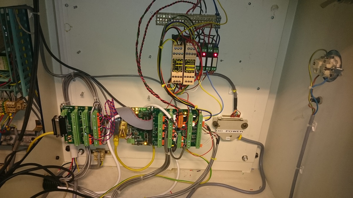

27 Jul 2017 09:01 #96565
by tecno
Replied by tecno on topic Help needed to get my 7i76E + 7i85S + 7i73 on my mill going.
No change still same issue, but now I see that CR1 is on when LCNC loads.
Maybe above start.txt can explain what is going on.

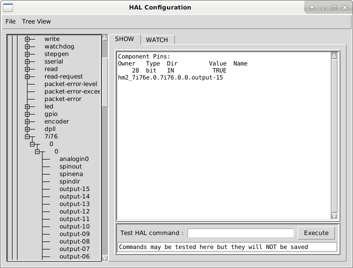

27 Jul 2017 10:07 #96570
by tecno

27 Jul 2017 12:13 #96579
by tecno
I have now tested following:
setp hm2_7i76e.0.7i76.0.0.output-15 TRUE
Output goes TRUE but nothing happens
Have looking at wires and all looks OK, can this have anything to do with CR1 led that is ON
In normal operation CR1 and CR2 will be off. If either is on after power-up there is a problem with configuring the FPGA.
So what next, any ideas what to do other than wait for Peter to chime in here.
Cheers
Bengt
Cheers
Bengt
