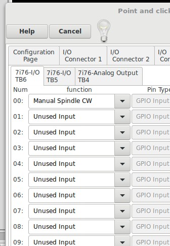

I noticed one more thing...
the configuration (PNCConf) of the first 4 inputs on TB6 of the MESA should be foreseen for the analog-inputs (0..3).
By the way it seems only digital variables can be selected:
Limits
Manual Spindle CW
In fact I tried to set Manual Spindle CW as variable and "it works", I mean when I give the 24 Volts as input I get the signal = TRUE.
Moreover it's not possible to set the variable "Custom Signal"... it does not remain selected.
Anyway at least the raw signal should be readable somehow, noting the changing voltage value
Limits
Manual Spindle CW

02 Mar 2020 10:08 #158988
Replied by PCW on topic 7i76e: MPG and Analog inputs with pncconf?
The analog value pins will only be available if you select sserial modes 1 or 2 for sserial channel 0 (via a "sserial_port_0=20xx" or similar token in the loadrt hm2_eth command line)
I doubt that pncconf supports connecting the analog signal, you must do this by hand editing the hal file

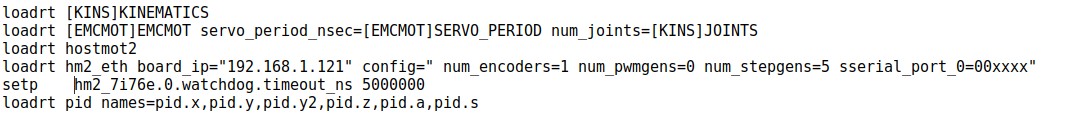

Andy told me about the sserial-port connection... is that running anyway through ethernet, right ?
Is the hm2_7i76e.0.read function definitely running?
-> how to check it ?

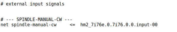

The sserial is defined in hal as following, is it correct ?
and the input signal (defined digital) is imported from PNCConfig as following (should be corrected with the analog signal when imported correctly)

You would need to change
sserial_port_0=00xxxx
to
sserial_port_0=20xxxx
or
sserial_port_0=10xxxx
to get access to the 7I76E analog inputs
to
or

finally I can read-in the analog input value from "hm2_7i76e.0.7i76.0.0.input-00"
-> how to define a variable where to store it
net "variable" <= hm2_7i76e.0.7i76.0.0.input-00 ?

what does define 20xxxx or 10xxxx ?
- Arro
- Posts: 52
02 Mar 2020 11:37 #158997
by Arro
Replied by Arro on topic 7i76e: MPG and Analog inputs with pncconf?
- Posts: 18122
- Thank you received: 5337
02 Mar 2020 11:43 #158999
The net command would be something like
net 7i76_analog0 <= hm2_7i76e.0.7i76.0.0.analogin0 => some_pin
The sserial_port_0="2134XXXX" statement sets
sserial port 0 channel 0 to mode 2
sserial port 0 channel 1 to mode 1
sserial port 0 channel 2 to mode 3
sserial port 0 channel 3 to mode 4
and disables sserial port 0 channels 4..7
man hostmot2
man hostmot2
