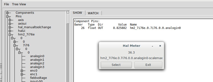

02 Mar 2020 11:56 - 02 Mar 2020 11:58 #159000 by Arro
setting
sserial_port_0=10xxxx
I get a scaling (scalemax) for the input parameter
There should be parameters somewhere to set min and max for the raw input signal
where to find them ? (guess a correct variable definition is involved)
Last edit: 02 Mar 2020 11:58 by Arro. Reason: complete post
02 Mar 2020 11:58 - 02 Mar 2020 12:00 #159001 by PCW
halcmd show param hm2_7i76e.0.7i76*
There are no min or max parameters for analog inputs
Last edit: 02 Mar 2020 12:00 by PCW.
02 Mar 2020 12:13 - 02 Mar 2020 12:14 #159002 by Arro
got it...
have some measurement on the input, with a max-scale of 36.3 Volts it gives a reasonable value
Thank you Peter and Andy !!

02 Mar 2020 12:26 #159007 by cmorley
Replied by cmorley on topic 7i76e: MPG and Analog inputs with pncconf?
In fact I tried to set Manual Spindle CW as variable and "it works", I mean when I give the 24 Volts as input I get the signal = TRUE.
Moreover it's not possible to set the variable "Custom Signal"... it does not remain selected.
Anyway at least the raw signal should be readable somehow, noting the changing voltage value
You type in the combo box to make a custom signal name.
But as Peter says it only connects to the digital pin not the analog.
02 Mar 2020 12:29 #159008 by cmorley
You would need to change
sserial_port_0=00xxxx
to
sserial_port_0=20xxxx
or
to get access to the 7I76E analog inputs
You can select mode 0 or 2 for the 7i76 in pncconf
