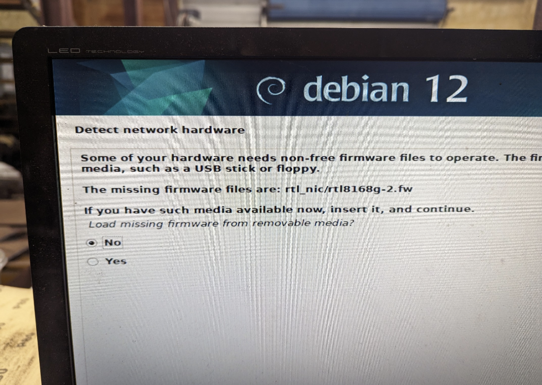

While installing Linux cnc it said two missing "non free firmware files" I attached a picture of one of the files it requested. I ignored it and continued and both Ethernet and WiFi connections work being connected to the Internet. Not sure if it's involved with the issues

20 Dec 2023 21:00 #288702
by rowow
Replied by rowow on topic LinuxCNC not connecting to 7i96S on 2.9.1
Sorry here's the photo attached.
