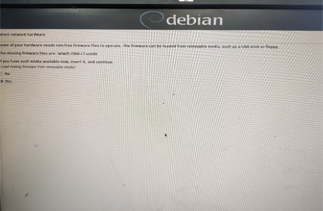

While installing Linuxcnc 2.8.2 I came across this error (attached photo) while installing the os. Should I ignore or install the following files first before continuing? Or install afterwards

Afterwards. Given you can boot up without, should be okay.
wireless.wiki.kernel.org/en/users/Drivers/iwlwifi

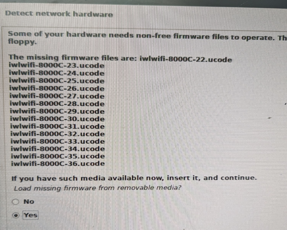

I got my new PC this weekend and installed 2.9.1 (made a brand new USB installation media redownloading the iso) but it still has the same issues of the error when starting Linuxcnc. Also while installing Linux the following error came up of missing files (attached photo)

Sorry image wasn't attached due to file size. Attached to this message

I would not worry about the WIFI until you need it.
