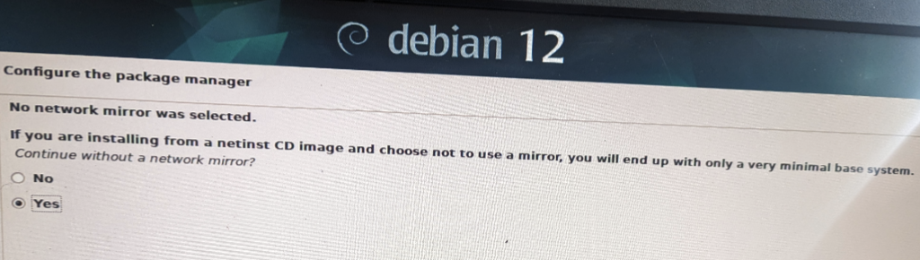

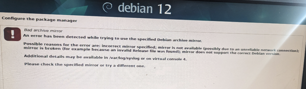

26 Dec 2023 15:42 #289095
by rowow
Replied by rowow on topic LinuxCNC not connecting to 7i96S on 2.9.1
It finally works!!! Reinstalled Linux cnc but this time didn't connect to the Internet. Attached photos of the error I was having. Before it wouldn't let me continue and said the grub wasn't installed and when I tried to do it more errors came up. Luckily it went through this time. Thank you everyone for the help. Is this a normal problem? I find it weird that the installation describes to connect to the Internet but that's causing issues. Maybe a bigger underlying issue

26 Dec 2023 15:52 #289096
Replied by PCW on topic LinuxCNC not connecting to 7i96S on 2.9.1
If you have a single Ethernet port on the PC, its easiest to use either WIFI or
an added USB Ethernet dongle for internet connectivity (and setup
the added device as the internet connection when installing)
