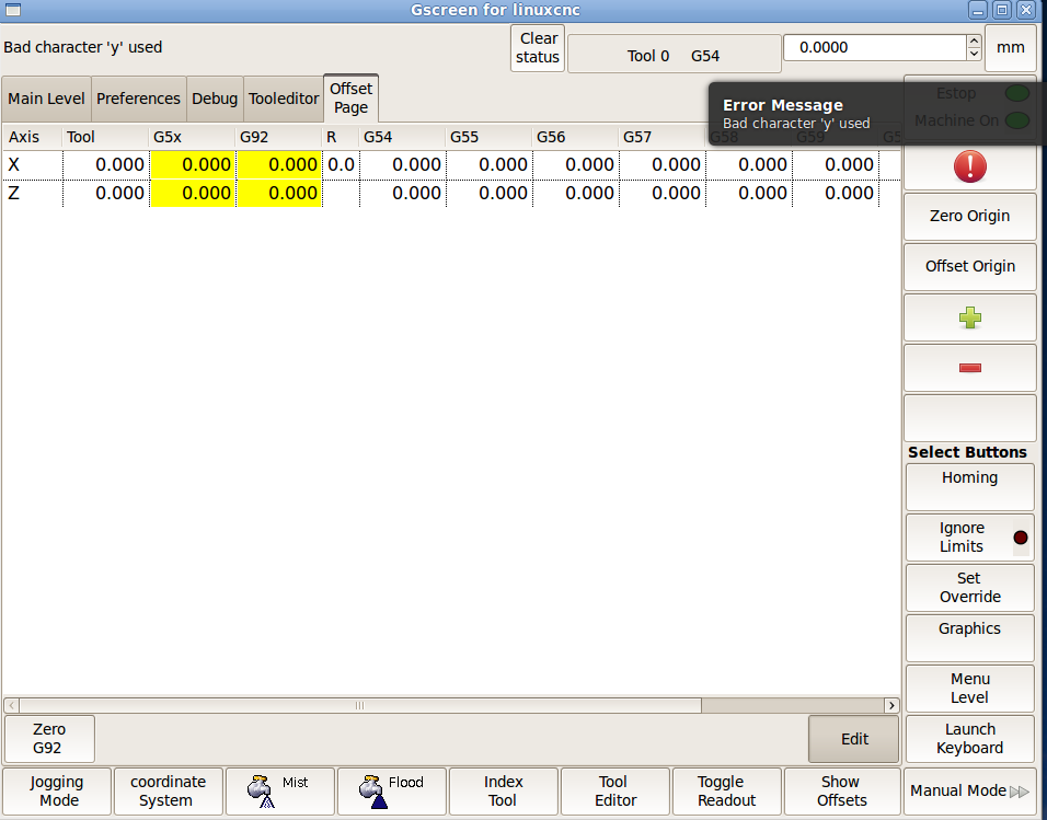

After Homing both Axis
i go to offset page and
click edit button to set G54
enter Z new value and after pressing
enter key an error shown on screen
( BAD CHARACTER Y USED )
Please tell the solution

Changing the Z-offset probably forces a G-code reload.
So the problem _might_ be in the loaded G-code file (especially if it is the Axis splash-screen code)
Replied by andypugh on topic Gscreen - a GTK / Glade / Python based screen
This message normally pops up if there is a Y-word in the loaded G-code on a machine with no Y-axis. (such as a lathe)( BAD CHARACTER Y USED )

OK, I could reproduce the error.
As far as I see, there is an error with the path selection for Lathe mode in
Col_edited in offsetpage_widget.py.
I don't want to mess around in the code from Chris, I am sure he will solve this very quick.
Until then please go to MDI Mode and enter:
G10 L20 P1 Z 124.001
where 124.001 is the offset set will be set.
To set an Offset in X just change Z against X.
Please see also:
G10 L2 P1
Norbert

i am upload the image
offset error
offset error

Thanks for the report and the error pinpointing.
I pushed the fix.
Chris M
