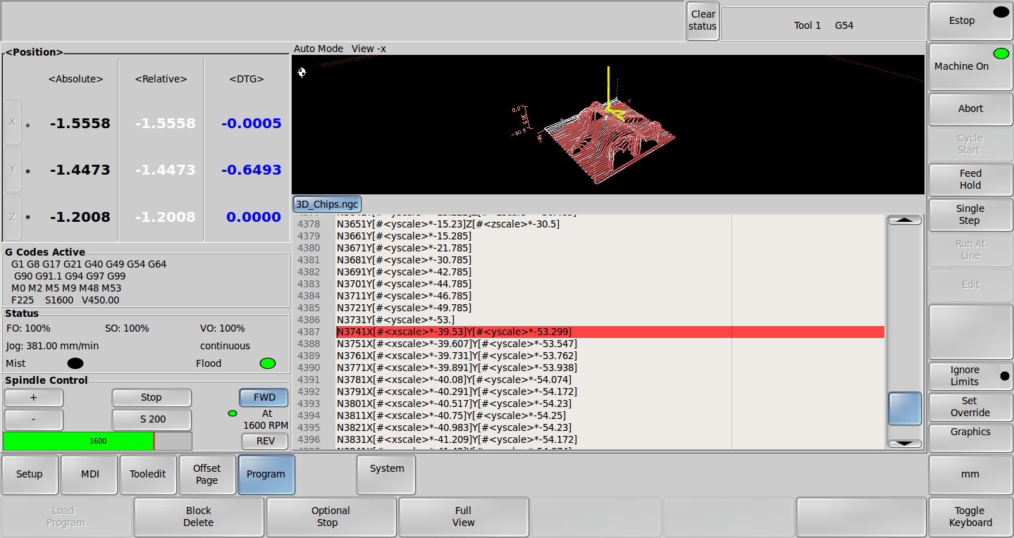

Hallo Chris,
while testing around, I found that you use as default theme "Redmond"
Could you change the default to "Follow System Theme"?
When the user sets a own path to preference file in the INI , like so
PFREFERENCE_FILE_PATH = ~/./gmoccapy_preferences
The File will be filed from gscreen with default values.
In my case resulting in problems, because you set the dro colors with standard values, so I get red numbers on a red background.
I found a solution, but I would apreciate, if you could set the standard colors to black.
I.e. If I say in gmoccapy:
self.data.theme_name = self.gscreen.pref.getpref('gtk-theme', 'Follow System Theme', str)
I get "Redmond" as result if the preference file does not exist jet. That happen after the first start if you set a new path in the INI File.
I could not understand, why I didn't get the default values I set in the code.
Norbert
11 Mar 2013 07:59 #31197 by cmorley
Replied by cmorley on topic Gscreen - a GTK / Glade / Python based screen
Hallo Chris,
why do you get the units for self.data.dro_units only from the preference file?
I think you should get the units from the INI File like so:
self.data.dro_units = self.inifile.find("TRAJ","LINEAR_UNITS")
if self.data.dro_units == "inch"
	self.widgets.toglebutton_units.set_active(True)
Users are always forced to enter units in the INI File, why again in the settings?
Norbert
I think you are confusing machine units and displayed units.
The ini [TRAJ} defines the machine (native) units.
The preference file defines the displayed units.
and in Gscreen there are two ways to select displayed units.
On the preference page the button set the starting unit type (inch or mm)
On the main page there is a units button that allows a user to change the units without saving it to the preference file.
for example :
My machine is mostly metric so I define the machine in metric units.
I work in inches, so I set the starting units to inch (preference file)
If I have a metric job, I can switch the display to metric (main screen) if that's easier for me.
but if I restart Gscreen it will be in inch again.
A user is free to change the displayed units as they see fit and at any time.
Chris M
11 Mar 2013 11:04 #31202 by cmorley
Hallo Chris,
Norbert
I use Redmond as a default because in Ubuntu 10.04 the default buttons are very difficult to see the difference between on and off.
Redmond seems to be readily available in the distributions we use and looks a bit more 'industrial'.
I am not apt to switch the default theme....BUT...
I can probably set it up so you can over riding the preference file references (so also the defaults) just like initialize widgets and signals etc...
Give me a little bit to try this ....
Chris M
11 Mar 2013 12:57 - 11 Mar 2013 12:57 #31204 by cmorley
Norbert:
next time you merge gscreen, try adding this to your handler file:
    def initialize_preferences(self):
        self.data.theme_name = 'Follow System Theme'
        self.gscreen.init_dro_pref()
        #self.gscreen.init_theme_pref()
        self.gscreen.init_window_geometry_pref()
        self.gscreen.init_general_pref()
Chris M

11 Mar 2013 16:36 #31208 by newbynobi
Replied by newbynobi on topic Gscreen - a GTK / Glade / Python based screen
for example :
Chris M
That is exactly what I understand, but IMHO after a restart of the GUI it should display the DRO in machine units. For most people switching between units is not necesary.
Norbert
