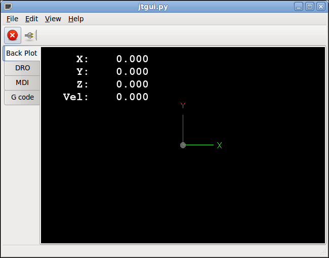

I can't download your program. - internal server error
If you use gladevcp objects then most of what I can see in the pic would already work.
there are Glade actions for power and estop, widgets for MDI, gcode and backplot.
There is no widget for DRO so that one you would need to program (though gremlin has a small DRO)

Ok, I have a gui piggy backed onto Axis... what is the minimum needed to run it stand alone?
The tool bar was a bugger to figure out... add a tool bar, add some hal actions, click on the button bar int the tree cause it disappears from the screen... then click on the edit button on the button bar then add your toggle buttons. Add a stock icon to each action and add the related action to the toggle button and select use action appearance... whew tough to sort out the first time.
The back plot will display a file that is opened and show tool movement but the dro seems too big I might move it somewhere else later. Also the screen doesn't pan like Axis does but rotates about the center... yuck.
John
