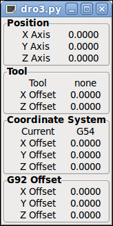

The DRO does it need to go into a top level window?
John
05 Aug 2012 18:44 #22856 by cmorley
Replied by cmorley on topic Re:Creating a GUI
i would think box or frame would be best.. it you right click a container you can force it to be a top level object.
but I can fix that later anyways.

05 Aug 2012 18:58 - 05 Aug 2012 18:59 #22857 by BigJohnT
Replied by BigJohnT on topic Re:Creating a GUI
Ok this one is in a window but I can redo it into a box.
File Attachment:
File Name: dro3.zip
File Size:1 KB
John

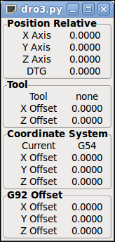

05 Aug 2012 19:12 #22860 by BigJohnT
A slightly different one...
