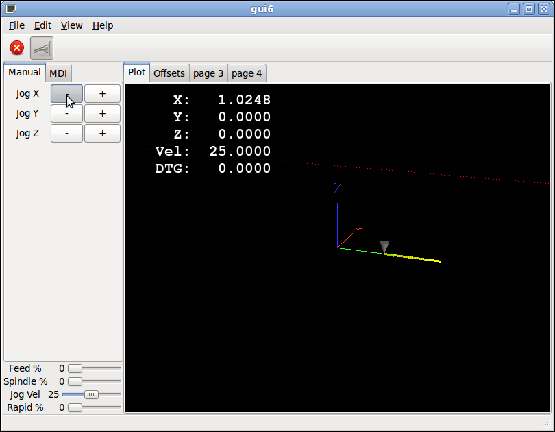

Just wanted to let you know that I got the DRO to update using linuxcnc.stat()!
Taking notes now like a mad man...
John

01 Sep 2012 14:01 - 01 Sep 2012 14:04 #23829 by BigJohnT
Replied by BigJohnT on topic Re:Creating a GUI
I just gotta tell someone... I've been making progress on writing a GUI from scratch. The latest hurdles have been testing for a postgui file and running it if found, jogging the axes around and getting the value from a slider to control my jog speed and presetting the slider to a default value on start up and enabling part of the screen based on conditions like is the estop out and power on.
I'll work on adding gui 6 to the custom gui tutorial. This will add a lot of information about building your own GUI.
