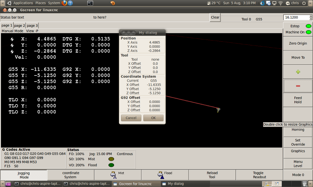

WEEEE! I make a huge breakthrough!
I added to my __init__
self.emc = linuxcnc
self.status = self.emc.stat()
and a button
def on_test_button_clicked(self, widget, data=None):
self.status.poll()
print self.status.g5x_offset[0]
and too my surprise when I click on the button I get something... where does emc.stat come from so I can see what all is there?
John
self.emc = linuxcnc
and a button
self.status.poll()
John

Yaaaay!!
yes the other stuff was boiler code for making a widget.
The emc.stat stuff was what I was wanting to show you.
info for emc.stat() which comes from module linuxcnc:
look through the example gscreen's emc_interface, emc_stats
self.emcstat is the same as your self.status.
also run an interactive python in a terminal (type python <enter>)
then:
import linuxcnc
then
help(linuxcnc)
gives a whole ton of info on the module
there is
stat()
error_channel()
command()
each has methods to call to do stuff.
Chris M
