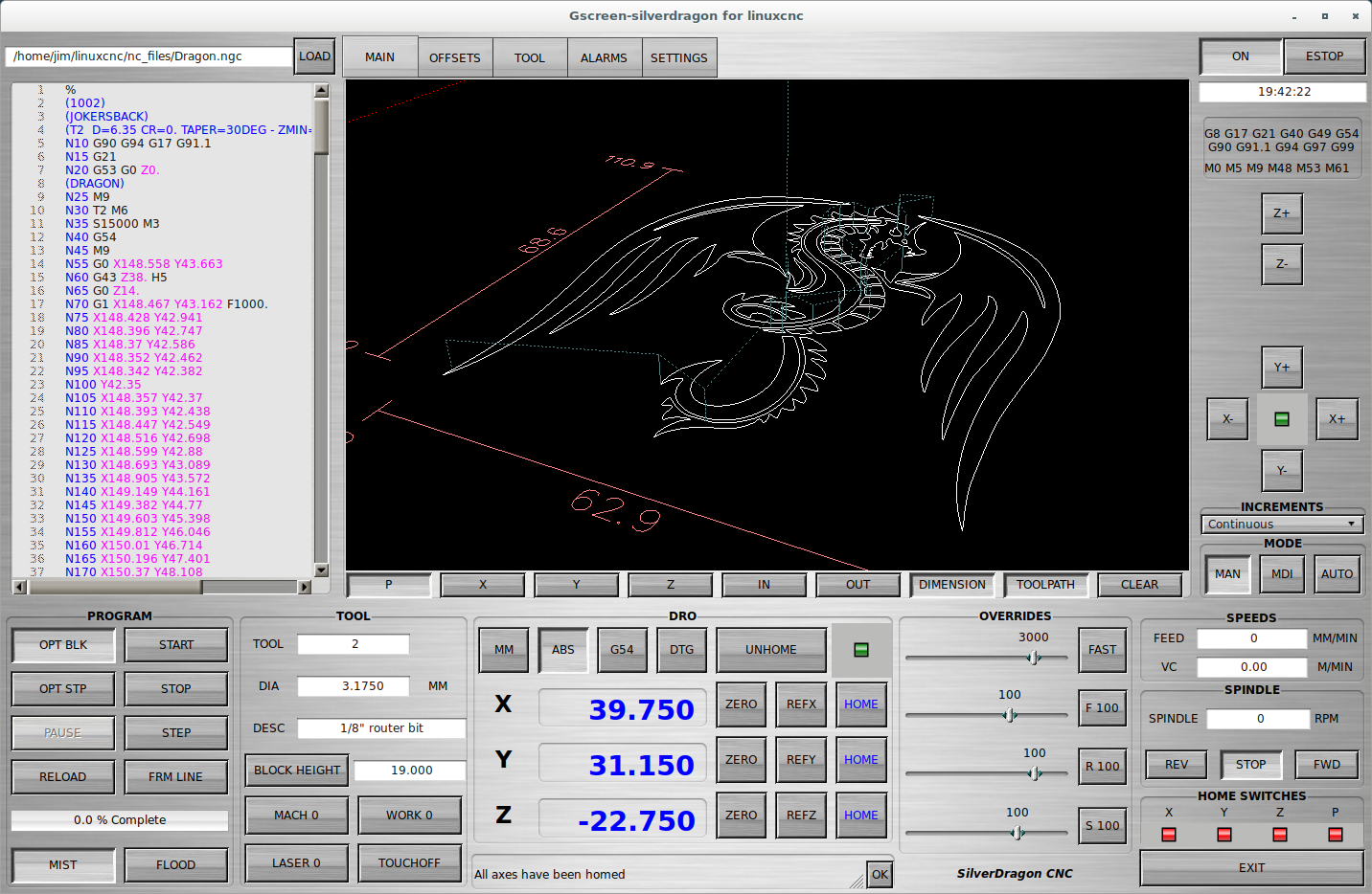

Replied by cmorley on topic Screen shots of gui designs
persel8
Hey that looks great - like the purple in there.
I think we should add this as a sample screen.
Looks like someone has got gladevcp to work with gtk3 so Gscreen could live on longer.
Chris M
Chris M

17 May 2019 14:58 #134052
by persei8
Replied by persei8 on topic Screen shots of gui designs
I realize some buttons are non-standard. The MACH 0 button moves the machine to absolute 0,0,0 position while the WORK 0 button moves it to relative 0,0,0. There may not actually be a reason to do this and could be changed in the future. I have a laser crosshair for marking 0,0 of the workpiece and the LASER 0 button sets the appropriate offsets. The TOUCHOFF button simply does a probe motion down to a touch plate for setting workpiece Z height. I also added a tool sensor and remapped M6 to automatically set Z offset height when enabled. When enabled, the BLOCK HEIGHT button becomes active and you set the workpiece height as measured from the table to the top of the workpiece.
- persei8
- Posts: 399
- Thank you received: 133
17 May 2019 15:04 #134053
by persei8
The purple just matches the CRUX theme. I did a lot of searching for themes at deviant-art and some others but finally decided to stick with available system themes.

18 May 2019 01:48 #134093
by persei8
Here's another look with minimal colours and a brushed aluminum appearance.

18 May 2019 18:31 #134208
Can you post your handler/glade/theme files? Or you could email me directly.
Chris M
Chris M
