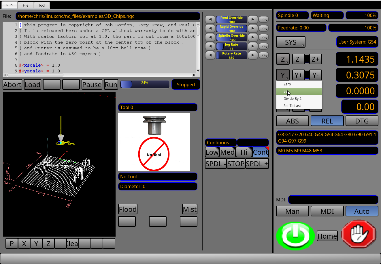

The first table is for editing user coordinate systems. The table is editable.
The zero buttons are for zeroing the current user system's axes - they do work.
You must be showing relative DRO position to see the effect of course.
The second table is for tool offsets and other wise works the same.
IIRC the tables were not reflecting changes made outside of them ...I'll have to look at them again to confirm.

If you look at the blender test screen - it has axes tool buttons for origin setting.
if you push and hold the buttons(axis letter with a little arrow on it) a list of options show allowing:
zero axis
set axis
divide axis in half
return to last setting

i looked at these again and pushed some work on them.
Now in the origin_offset table you can see the action of the zero button in the table.
i did the same for the tool offset table.
i do see what you mean about the zero buttons - maybe they should zero the tool offset - that would make more sense.
Also If you edit the tool offsets in the widget it doesn't run a G43 to update the controller.
I could automatically add that, so when you edit an offset it updates the controller or
I could add a G43 button to force an update. What do you think?

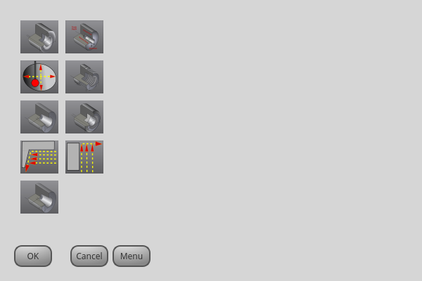

23 Oct 2018 10:34 #119251
by cncnoel
Replied by cncnoel on topic Screen shots of gui designs
I enjoy graphical interfaces they are more intuative, and your interface looks quite slick.
Have you seen my interface at post #78341 where I was obsessed with quick setup routines, especialy touching off and edge finding. My goal was to be able to bolt some stock on the table then easily drill a set of holes, or machine a slot etc without having to write a program for each step.
Haven't been in the shed for quite a few months & the fingers are getting a bit itchy for some CNC action, I've enjoyed reading about your new progress and am determined to get a bit of "Shed Time" soon!

Calling a tool change with g43 would still be required - to change that requires remapping the tool change routine.
The tool offset widget would usually to used to modify offsets already applied to the tool.
To me it is Intuitive to modify the offset in the table and have that applied immediately.
The only caveat I can see is if you had not applied an offset (on purpose) then emitted the table - it would apply an the offset.
Linuxcnc is not so good about (after the fact) being able to check which offset is applied, only that _an_ offset is applied.
i could make either behavior selectable.
Chris M

23 Oct 2018 20:33 #119283
My experience with CNC at work was a lathe - a very old one.

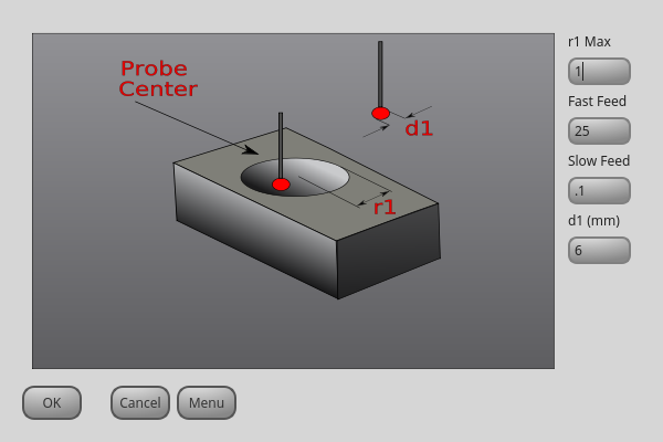

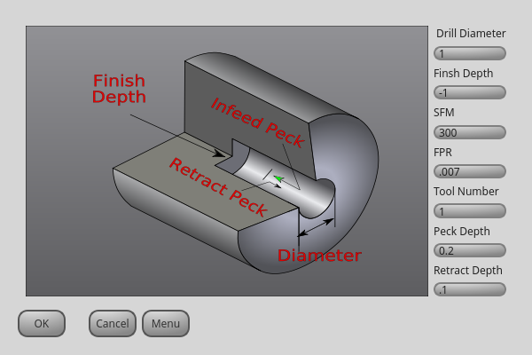

I would love to add some probing and set up screens but haven't done much mostly for two reasons:
I suck at making images/icons.
There are few examples of relatively simple probing routines that are universal enough, that I can see.
I did do some preliminary work on a macro widget - based on Andy's lathe macro work and it also has a very simple probe routine.
I'm only one guy so have been busy with getting the more important screen widgets functional before getting back to macros.
Though if people want to use/test a feature, I generally redirect my efforts to help.
Chris M
