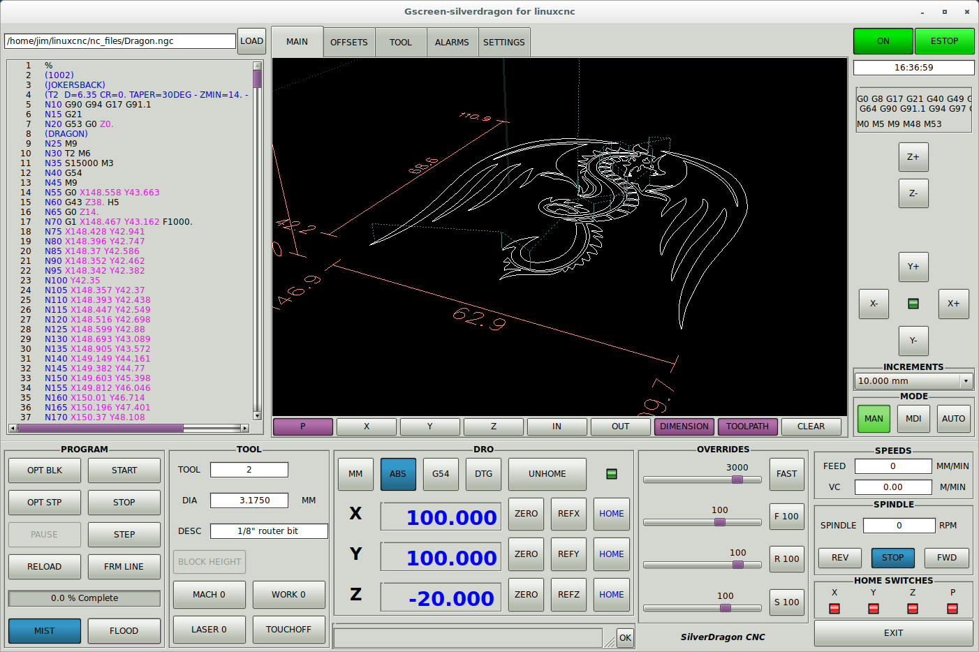

16 May 2019 22:58 #134016
by persei8
Replied by persei8 on topic Screen shots of gui designs
Screen shot of my GTK panel built with gscreen. Once you figure out how to actually use gscreen, the rest is relatively straight forward. The layout was inspired by the probe basic development and much of the python code is taken from gmoccapy. This is a single purpose, customized gui for a 3 axis router. It doesn't even have a spindle though one can be added later. Now it's time to quit fooling with the machine and start making stuff with it.

16 May 2019 23:13 - 17 May 2019 00:31 #134018
by Grotius
Replied by Grotius on topic Screen shots of gui designs
@Jim,
Very good done !
It's nicer to embed your picture in the post like this :
For c coded gui's i leaved gtk+. Try to invest your time in QT coded gui's !
I wonder who has already has the whole linuxcnc project code adapted in one QT project.
This time will come soon. Just a matter of time. Maybe a clever student will pick this up.
The button Mach0 attrack's me in some way. I keep looking at this button. Is this a full speed button ?
