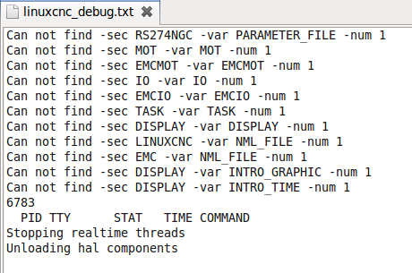

- aer73
- Posts: 21
28 May 2016 17:24 - 28 May 2016 17:41 #75192
by aer73
Replied by aer73 on topic My custom designed GUI
Last edit: 28 May 2016 17:41 by aer73.

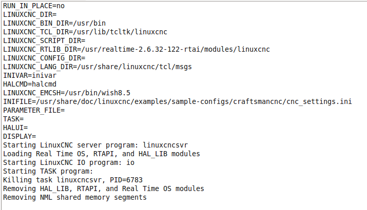

- aer73
- Posts: 21
28 May 2016 19:42 #75194
by aer73
Hello BigJohnT.
Many thanks and sorry, i dont know what is better for see the problem i have.
Here i get the .txt file with the message.
I hope anyone can help me.
Many thanks in advance.
Kindly regards.
Kindly regards.

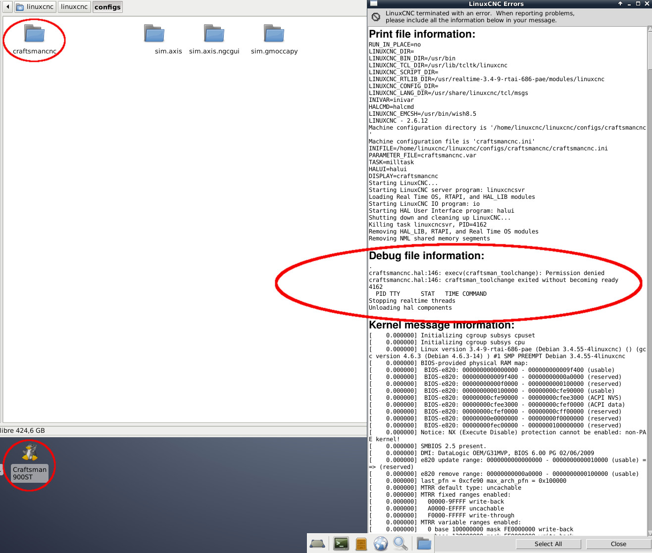

28 May 2016 21:31 #75198
by BigJohnT
Replied by BigJohnT on topic My custom designed GUI
My SWAG is you have a permission problem with the craftsmancnc.hal file. My second SWAG is somehow it is "owned" by root and not you.
Right click on the file and look at the permissions tab to see who the owner is.
JT
craftsmancnc.hal:146: execv(craftsman_toolchange): Permission deniedRight click on the file and look at the permissions tab to see who the owner is.
JT

- aer73
- Posts: 21
28 May 2016 22:41 #75203
by aer73
Hi BigJohnT.
I check that you say, iḿ the administrator and have Read/Write permissions in all.
Dont know what more to do.
Many thanks otherwise.
Kindly regards.
Kindly regards.
