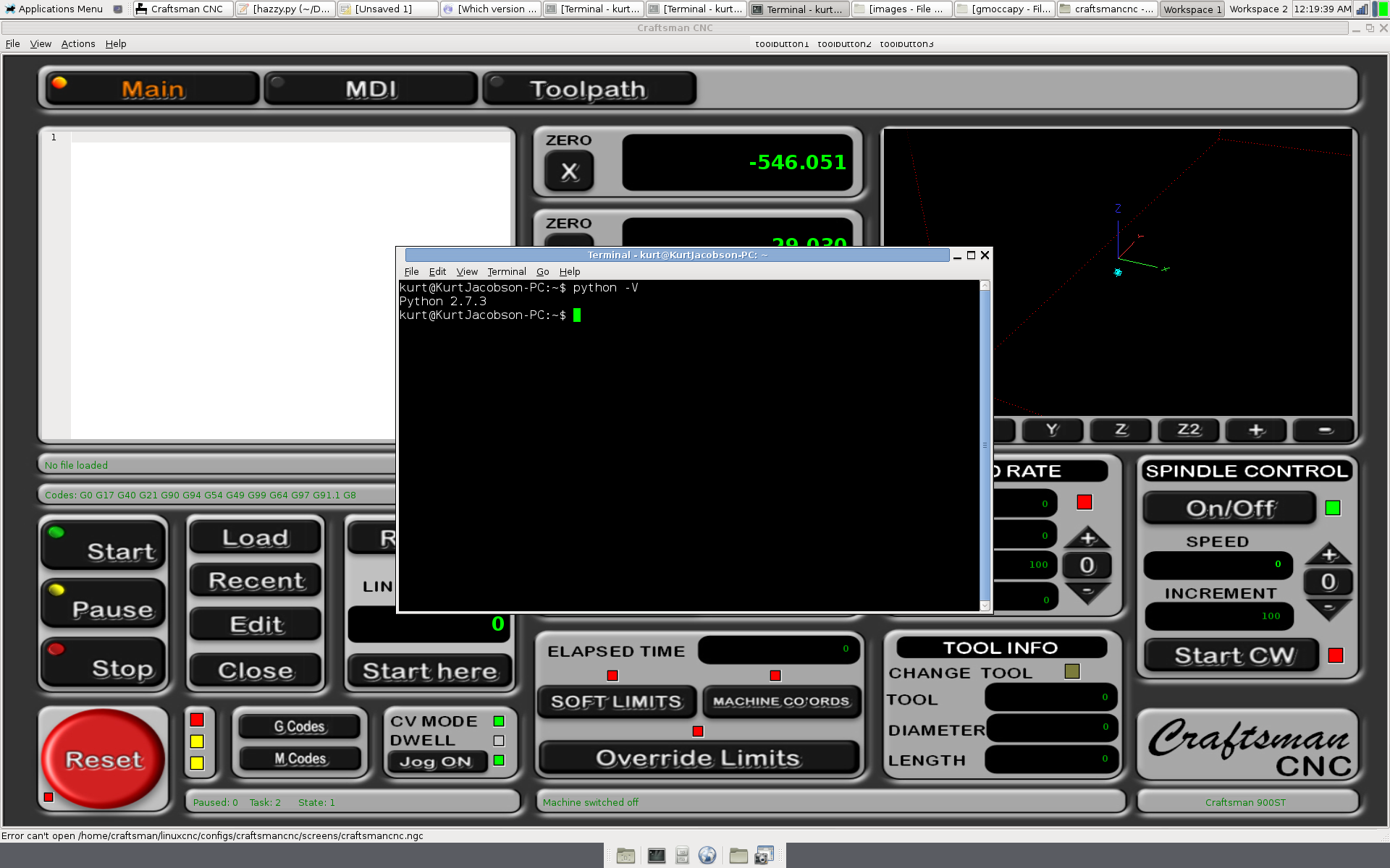

I just checked my python version using $ python -V and it says I'm running 2.7.3. CraftsmanCNC seems to start and run fine, see the attached screen shot. I can upload the directory in which I have CraftsmanCNC installed if that would be helpful.
Kurt
EDIT: It is starting to come back to me. I think I remember having to change some floats to ints or something like that to get the GUI to start without errors, maybe in the scaling function? Whatever it was I don't remember it being a lot of work to get going, and at the time I had very little if any python or linux knowledge, and I still don't
Kurt

I just ran some diffs on the original craftsman .py files and on my craftsman .py files in my config directory. Here are the results:
I ran diffs on all the other python files and as far as I can tell I did not make any changes to the code other than those listed above. I did add easygui.py to the craftsmancnc directory.
Again, it has been a long time (1-2yrs?) since I was playing with this GUI, and I can not remember exactly what I did to get it running. All I know is that is does run, that I have Python 2.7.3, and that I was not very impressed with the GUI. I will upload my directory when I figure out how to make a tarball.
Hope this info helps!
Kurt
- In craftsman.py I modified the paths on lines 18 and 25 to match my user-name. Also, it looks like I removed some parentheses on line 1122, but can't see any reason why that would be necessary.
- In vfd_spindle.py I modified the path on line 13 to match my user-name.
- In craftsman_toolchange.py I modified the path on line 7 to match my user-name.
- In vfd_controller.py I modified the path on line 10 to match my user-name.
Kurt

If I may dredge up an old thread, has anyone actually got this successfully installed and running? It's kinda running but there are problems I cannot resolve on my own. For example, the screen does not rescale and it complains about expecting ints and getting floats when jogging. If anyone is still interested in pursuing this, I'd like to participate otherwise I have to give up on it. Thanks.

The author certainly put some time, effort, and ingenuity into the Craftsman UI, but I spent a good deal of time trying to make it usable a while back and eventually came to the conclusion that it was not worth the effort.
If you are interested in a UI of this type, I would suggest you check out the excellent work Chris Morley's has done on QtVcp. If you were so inclined, you should be able to take the background images from Craftsman CNC and overlay QtVcp widgets to make a working interface. I think this is the the current dev branch here: github.com/LinuxCNC/linuxcnc/tree/qt5vcp_py2
Also, as sam was kind enough to mention, you might be interested in hazzy. It allow you to rearrange the UI however you like, even on the fly, simply by dragging and dropping widgets into the display area. It is not complete yet, but it is more or less functional and I hope to be able to work on it some more soon. This is the current dev branch: github.com/KurtJacobson/hazzy/tree/GTK3
Kurt
