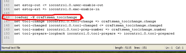

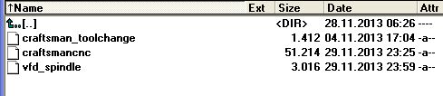

"...he is missing file craftman_toolchange..."
Good. How this problem eliminated?

Replied by newbynobi on topic My custom designed GUI
Just set the correct path to it or copy it in your config dir, depending where the main program searches for it.

15 Sep 2016 19:36 - 15 Sep 2016 19:37 #80477
Replied by rodw on topic My custom designed GUI
Your error messages have isolated exactly what is wrong ( not able to find a file) and the line number its happening on. So one of 2 things is wrong.
1. The file name is wrong (which it isn't)
2 The search part is telling Linux to look in the wrong spot (which by elimination is the problem).
So right now its like you are playing hide and seek and the child you are looking for is hiding in the bedroom when you are looking in the living room. Maybe the reason why you are not looking in the bedroom is becasue when you started the game you parents (Linux) said the bedroom was out of bounds. (eg not in the default path).
So the options are:
1. Fix the default search path so you can look in the right room (best option)
2. Change line 146 so it is a fully qualified path so you know exactly which room to look in straight away. (But isn't that cheating when the room is out of bounds?)
So the options are:
