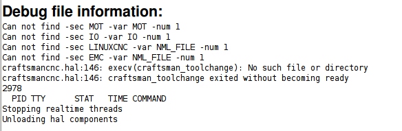

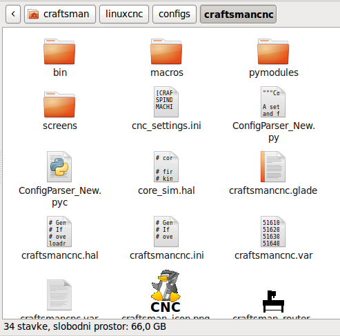

- newbynobi
- Posts: 1931
- Thank you received: 394
27 Jul 2016 14:32 #78073
by newbynobi
Replied by newbynobi on topic My custom designed GUI
craftmansns.hal Line 146
he is missing file craftman_toolchange
Norbert
Norbert
