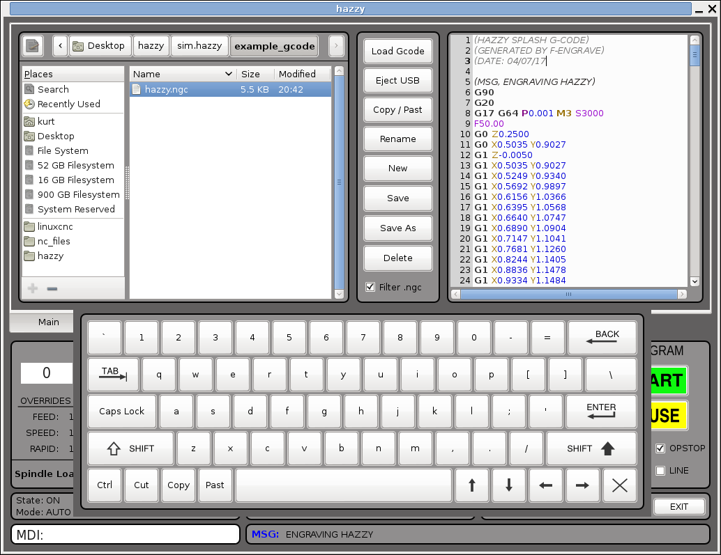

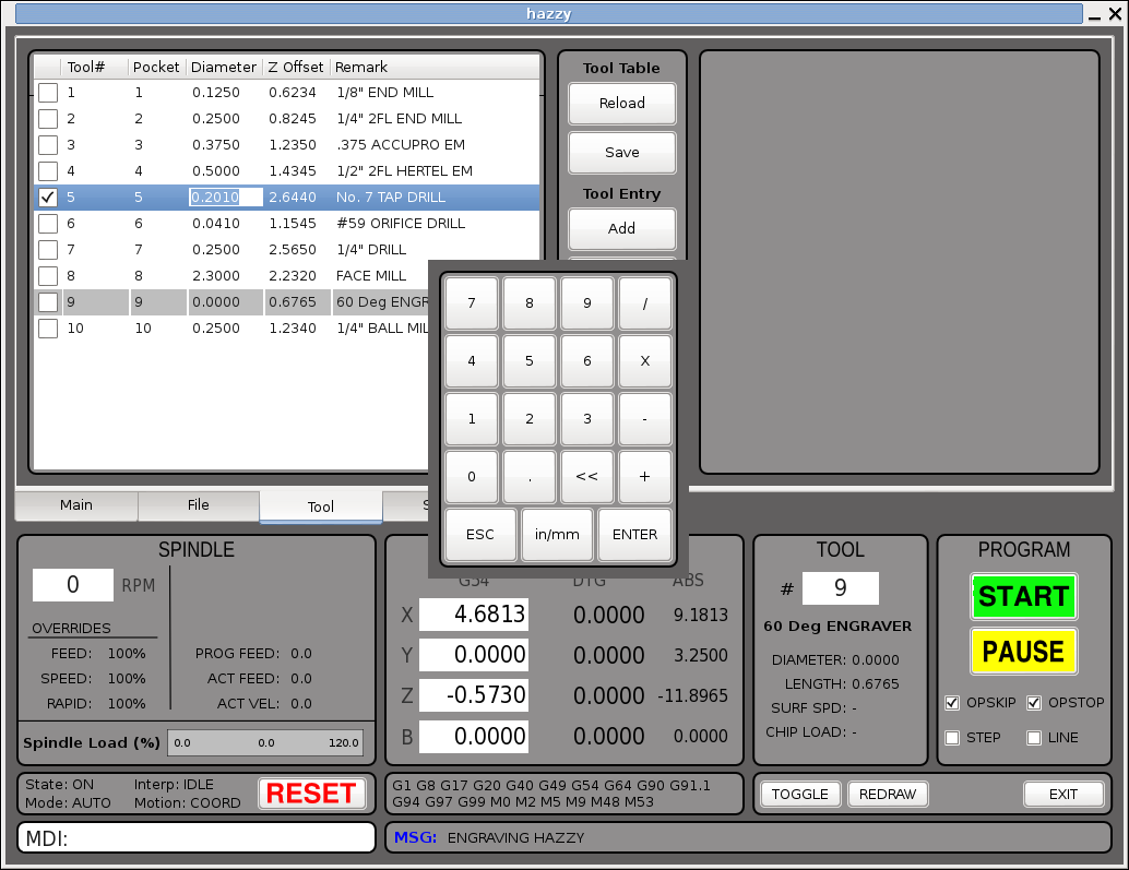

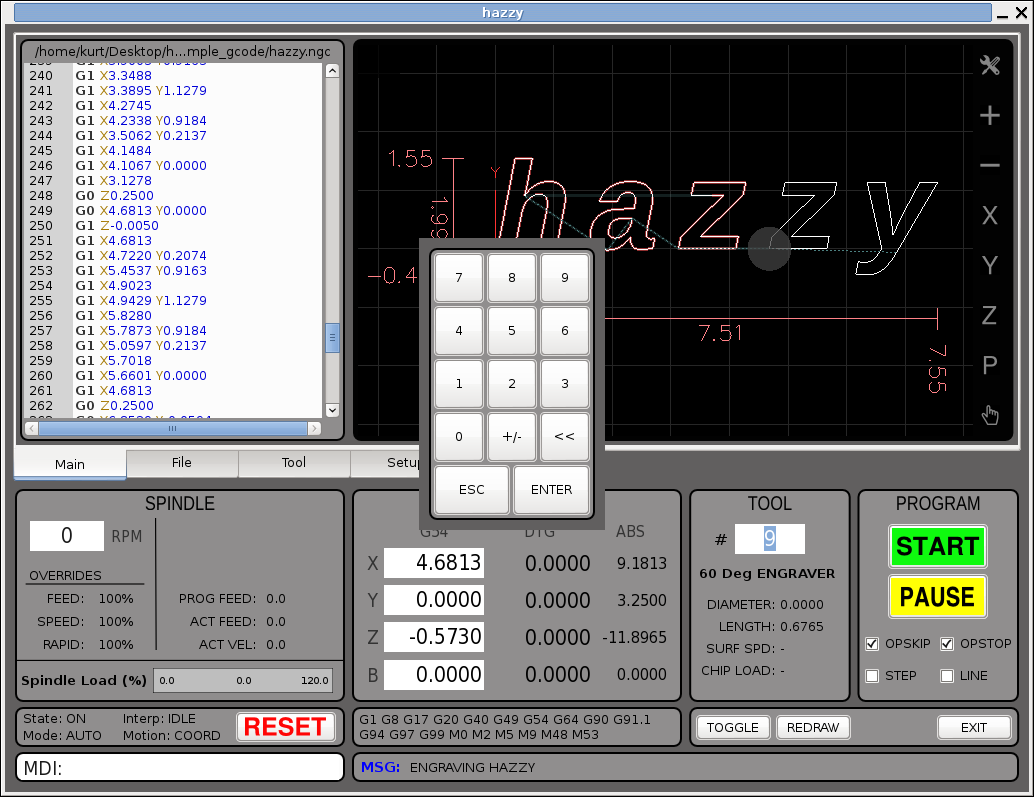

I originally posted this in the "Screen shots of gui designs" thread. Since there appears to be interest I am opening this thread for further discussion. Please feel free to ask questions and post suggestions/comments. I will also be updating this thread as I make changes/improvements to the GUI.
This is hazzy.
I made this UI for use on my RF45 type milling machine. It is intended for use exclusively with a touchscreen and a basic control panel or MPG. There are popup keypads and numpads on all entries. It borrows a lot of code from Gmoccapy, Gscreen and the VCP widgets. It supports up to 5 axes, including gantry type machines. It is far from finished but mostly fully functional.
Source code is here:
github.com/KurtJacobson/hazzy

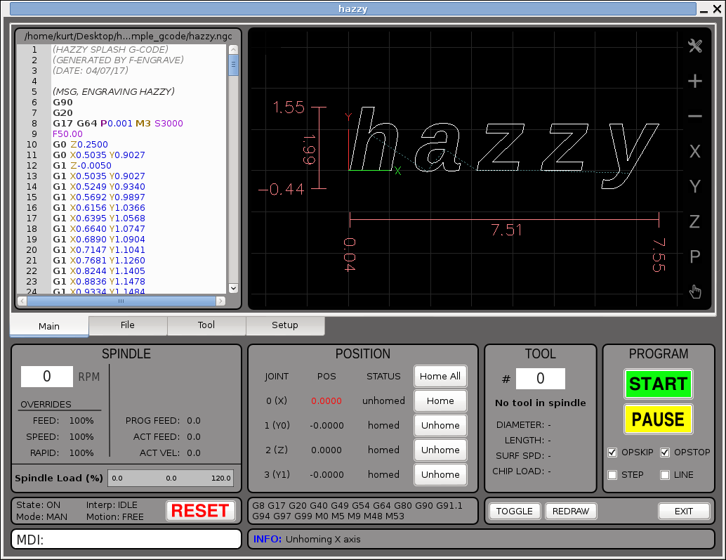

I have added joint position DROs and homing buttons that are displayed when LCNC is in motion mode FREE. Note the labels which indicate the joint number and its corresponding axis. This is on a sim gantry with double Y axis (XYZY config).
Kurt
EDIT: I am trying to decide if the joint DROs should be displayed whenever motion mode is FREE, for all types of machines, or only if the machine has not trivial kinematics. There is some advantage I guess to hiding the fact the joints even exist to users that don't really need to know about them, but then joints aren't all that scary after all. What do you all think??
Thanks!
Kurt

As a new user and also due to the changes that have been made in master to support joint axes, I would drop joints totally unless they are required for non trivial kinematics. There are no home function on axes, just on joints so I would go one step further and just present a home all button. If you want to present individual home buttons you will be using joints and attempting to map stuff in the gui which is obsolete and it will cause you a lot of extra work and pain.. If this is a new GUI then build it for master and not for V 2.7. Don't put the effort in to support V2.7, release your gui when v2.8 goes mainstream.
Because I have a joint axis machine running on master to get JA support, I have identified a few bugs in Gmoccapy because of the un anticipated changes to tbe joints, axes and homing models so have found these problems and have seen fixes flow on in other Guis following my reports.

I forgot to mention you cannnot allow a user to home just one side of his gantry and tear the machine apart as your current version permits.

Rod, thanks for the input! I have been following your threads with interest, and they have proved invaluable for helping me to foolproof my UI for as much as I can. In fact, I have at least one comment in the code that refers to you, and some problem you had with homing your gantry!
I am developing this GUI for 2.8, so I have to home joints, whether the user sees it that way or not. Regarding your concern about accidentally homing only one side of a gantry, as long as the INI file is correct, that is not a concern with the current master. For example if I click the home button for joint 1 in the screenshot above, LCNC will simultaneously home joint 1 and 3 and keep them synchronized so as not to skew the gantry. It knows to do this since they are on the same axis. I remember you had to modify some code in Gmoccapy to get your gantry to home safely, I don't think that is necessary anymore.
