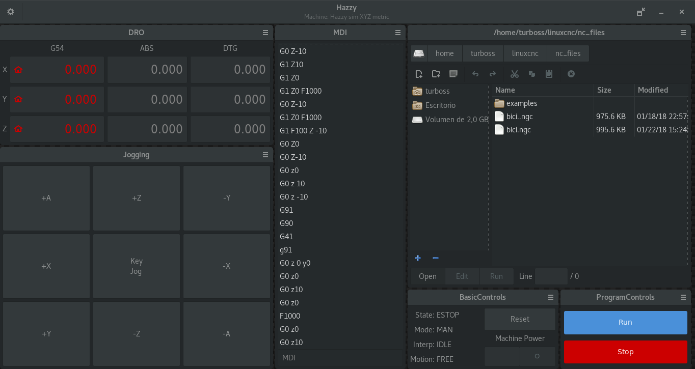

hazzy - Another touchscreen GUI
- TurBoss
- Posts: 134
- Thank you received: 81
21 Mar 2018 09:32 - 21 Mar 2018 09:32 #107664
by TurBoss
Replied by TurBoss on topic hazzy - Another touchscreen GUI
Last edit: 21 Mar 2018 09:32 by TurBoss.
The following user(s) said Thank You: tommylight, Lcvette
- Posts: 22049
- Thank you received: 7509
21 Mar 2018 09:56 #107666
Replied by tommylight on topic hazzy - Another touchscreen GUI
Looks nice!
Thank you.
Thank you.
