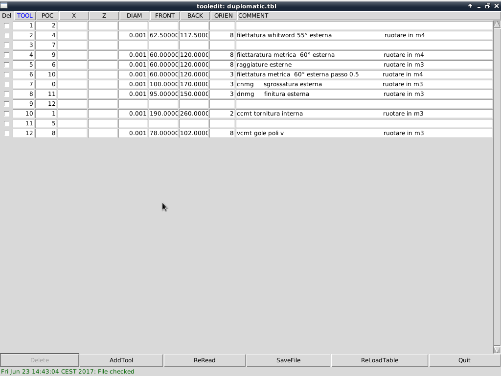

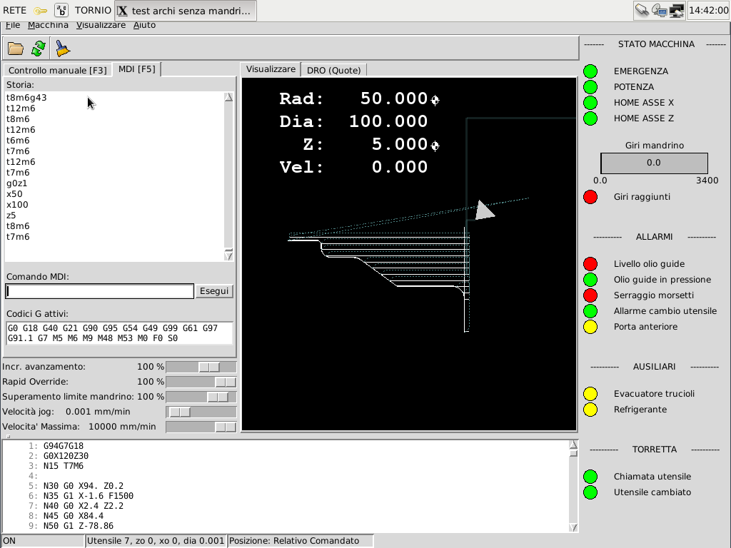

Massimo,
Thanks for the screen shots! They are very useful.
I am making progress toward adding the lathe mode. Hopefully I can get lathe mode at least to a testing point before I go out of the country for most of next month.
