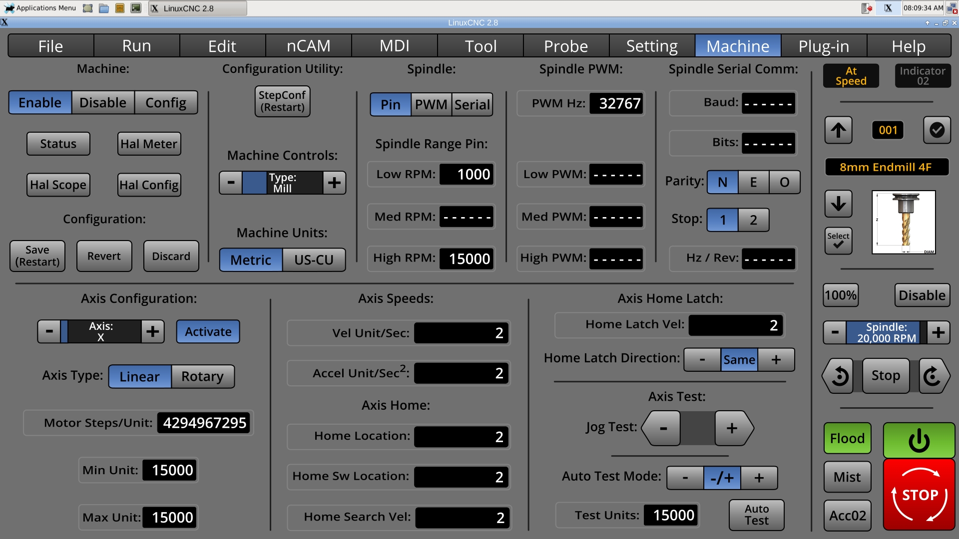

Aaroncnc, thank you. I appreciate the support. The interface proposal is mostly done. So far, I am working on design and control arrangement, trying to find common ground for the other interfaces--all in the style of Blender3D.

As far as the interface, the Machine menu has been included the screenshots for weeks.
Except for the spindle control, which are a big grumble of mine, I am trying to consider: What settings are universal to all CNC machines and axi.
Grijalvap, currently, there is a method to lock out the Machine UI using the "Enable/Disable/Config" menu, but perhaps a password would be a good idea. How are configurations locked out with StepConf.

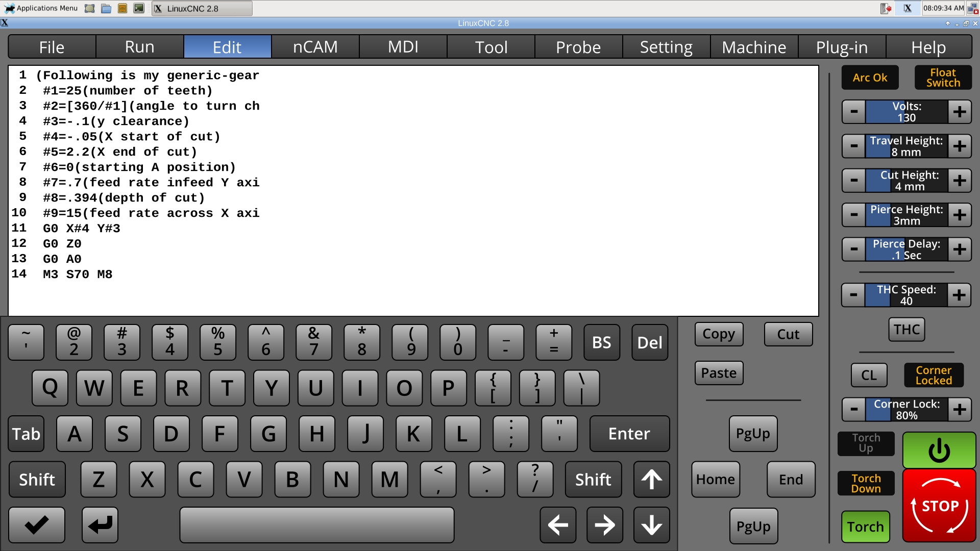

After mocking the run menu very roughly in qtvcp, I find the gcode editor may be too narrow to see a lot of the code, forcing one to scroll. i wonder if moving the editor above the graphics and putting the graphics on the far left would help in that regard?

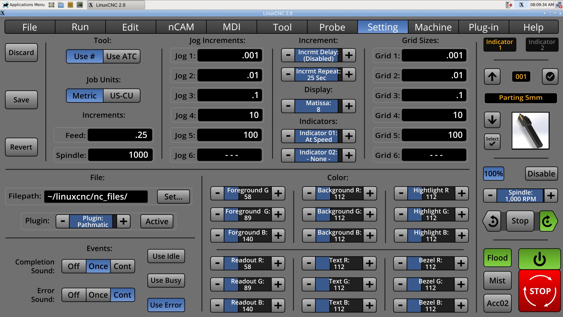

I just gave some more thought to the number of digits. 10 is too many.
It makes it harder to read, and the extra digits tell you how many atoms there are on the part. They add noise, not information.
So, why not move the ABS / REL and mm / inch displays inside the box. That keeps the aspect ratio and gives more information.

Andypugh, I have you covered. There's a Mantissa setting in the Settings menu : )
(The Jog Increments may match the Grid Sizes in a later version, if anyone wants more settings. "Pathmatic" is just a dummy plug-in name.)
Chris Mmorley, Is this better?
