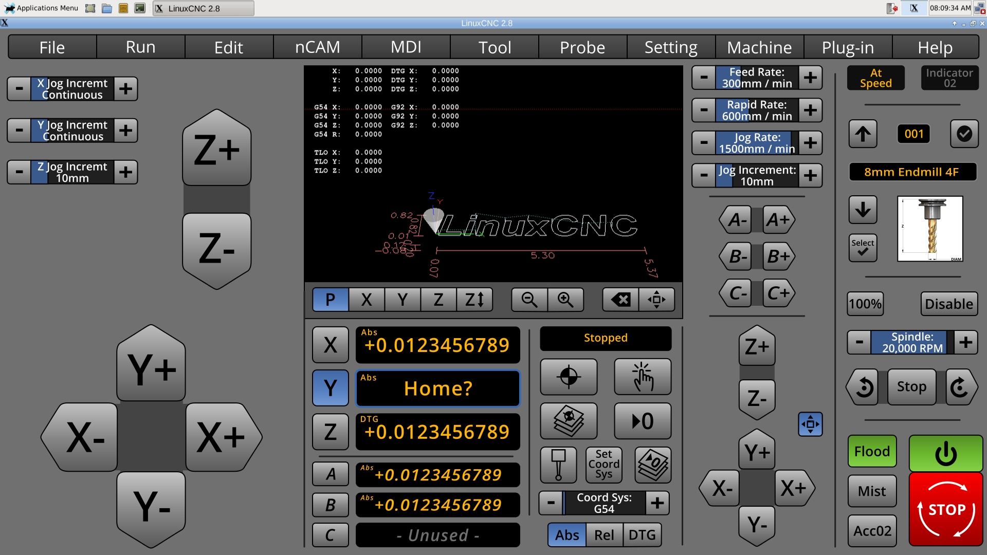

* Updated the Large Jog control panel for individualized Jog distances.
The large jog would be activated by clicking on the small button near the small jog.
Adding the individualized Jog distance controls would allow the user much easier semi-manual milling, for operations where the other axis are dimensionless, such as during facing operations and stock squaring.
The user would often set the z and y to continuous, and then set the z for the step-down. Okay, 10mm is a little much for DOC : )
I wish I had this on Axis a few weeks ago. I wonder if I can make a surface grinder attachment for my mill : O

06 Aug 2018 11:57 #115665
I wonder how useful and practical that is with a touch interface?
I tend to MPG jog to Z height, then do the feed moves with MDI. Then I don't have to watch (and don't need to keep my finger pressed to a touch-screen)
MDI moves can be queued, so yesterday I typed:
M3 S600
G1 F50 Y50
X32
Y-60
X45
Z-8
Y50
X32
Y-60
Then turned round to use the lathe

Send complementary MPG jog to...
For each pass, without these kind of controls the user would need to:
I know.
In the design, I've included a more-or-less copy of Axis's MDI, though, I would not want to rist a typo. Yes, I left that in there on purpose, but no, it was a real mistake.
- Mill off the top of the surface.
- Set jog size
- Step down
- Set to continuous again
I know.

I have no idea how many people machine using the jog keys. I pretty much never have. I would be even less likely to do it with a touchscreen. I just don't think it would be comfortable.

Andy, with Axis, the issue is a little deeper than just a touch screen. I would rather have a keyboard for jog-milling but in Axis there is a constant round-robin procedure to facing.

What means Acc02 to Acc06? It was asked on IRC last week.. I guess multiple outputs ?
The Gremlin interface is way to small to look at when executing a program. It must a be minimum of 60% of the screen fit.
Current selected tab is not highlighted, are you on the deeper touch screen panel at this moment?
A way too many digits at the dro side, oops how to solve this?
I will stay on topic Brenda. But if i make a suggestion, why don't you give it a go?

I've considered the buttons around the On/Off switches for coolant, and whatnot, generic accessory buttons, that the user can configure to whatever on/off pins they would want. I will make some kind of presentation soon. The time I can devote to the interface will be ending soon.

Is there a plasma screen in the future?
I would use this instead of axis absolutely. Nice job.
Dont forget a means for turning off the offsets leaving just the axis dro’s.
