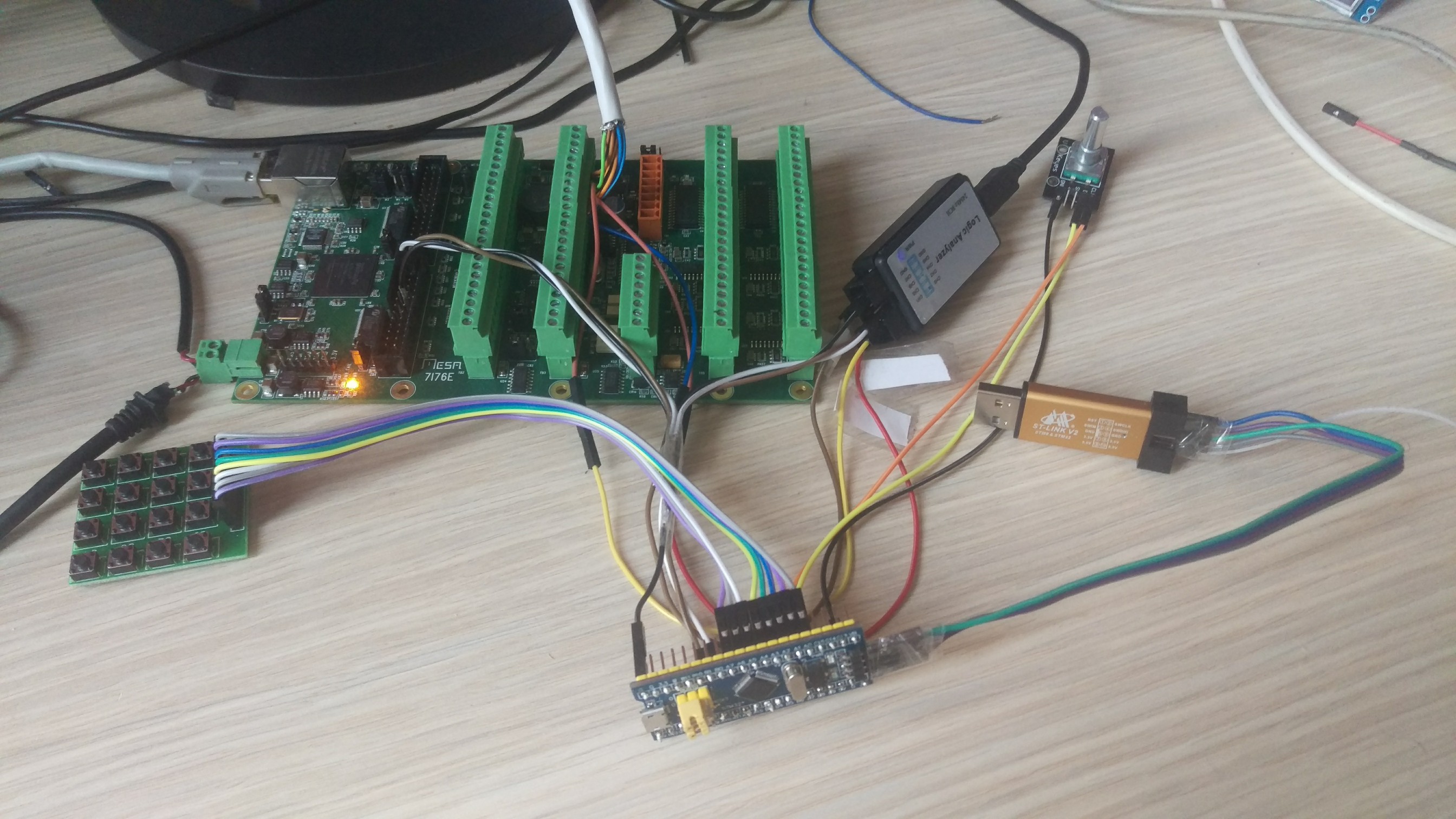

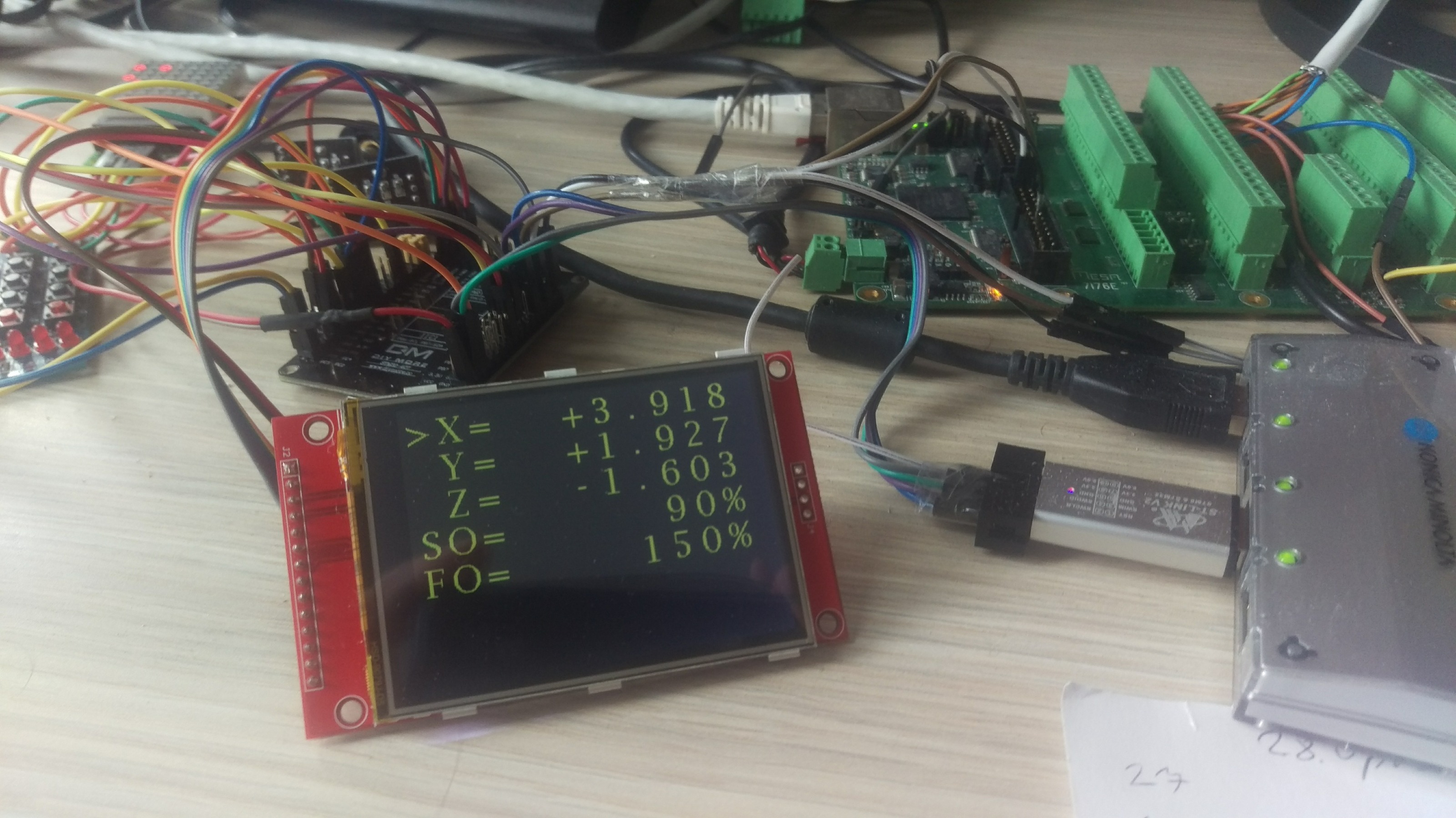

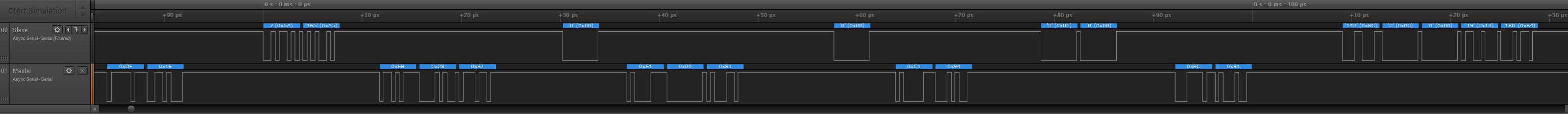

long time ago I try to "hack" sserial. It is posible.
I had to make new firmrware for my 7i76e, because i need ttl on p2 no rs485. Than I used logic analyzer and listen communication between 7i76e and 7i73
after a long time and many attempts my stm32f1 and 7i76e speeks together. Then I migrated to stm32f4, because f1 have not enough pins for keyboard, encoders etc.
(atmega is fine, but not for fast communication on 2,5Mb speed)
here is a very simple example.and log file from analyzer.
and source code made in stm32cubemx and uvision arm keil for f1 (no keyboard attached only sserial communication) and f4 (keyboard attached)
only for ilustration. I am not programmer.
Martin
