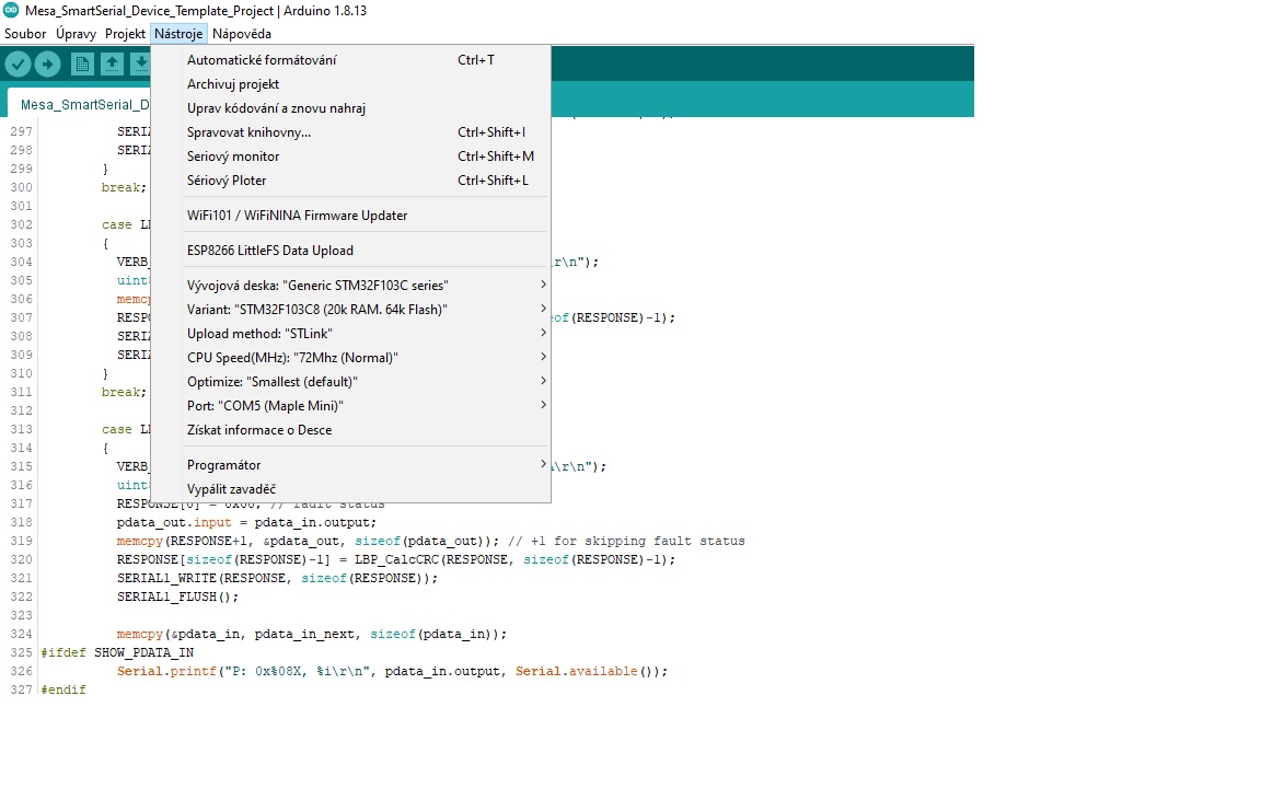

Tomorrow on work. I can make simpliest example. send 1 bit to sserial card stm32f103c8 bluepill and turn on/off led and 1 bit back with led status.
Now I am working on versatile template, where will be possible to do select types from predefined lines and program makes everything itself. calculete PTOC, create variables etc. Of course except for HW pin operation.
Martin

Hi,Here is very simple example
I change cca 10 lines in fdarling template
there is
1 bit from LCNC to stm32f103c8 turn on/off pc13 buildin led
1 bit from stm32f103c8 to LCNC copy input to output
I use int_8 for 1bit because opposit side automatically align size to whole byte.
Sorry my arduino ide is automaticaly set to czech language. but perhaps the picture shows how to set it up.
Martin

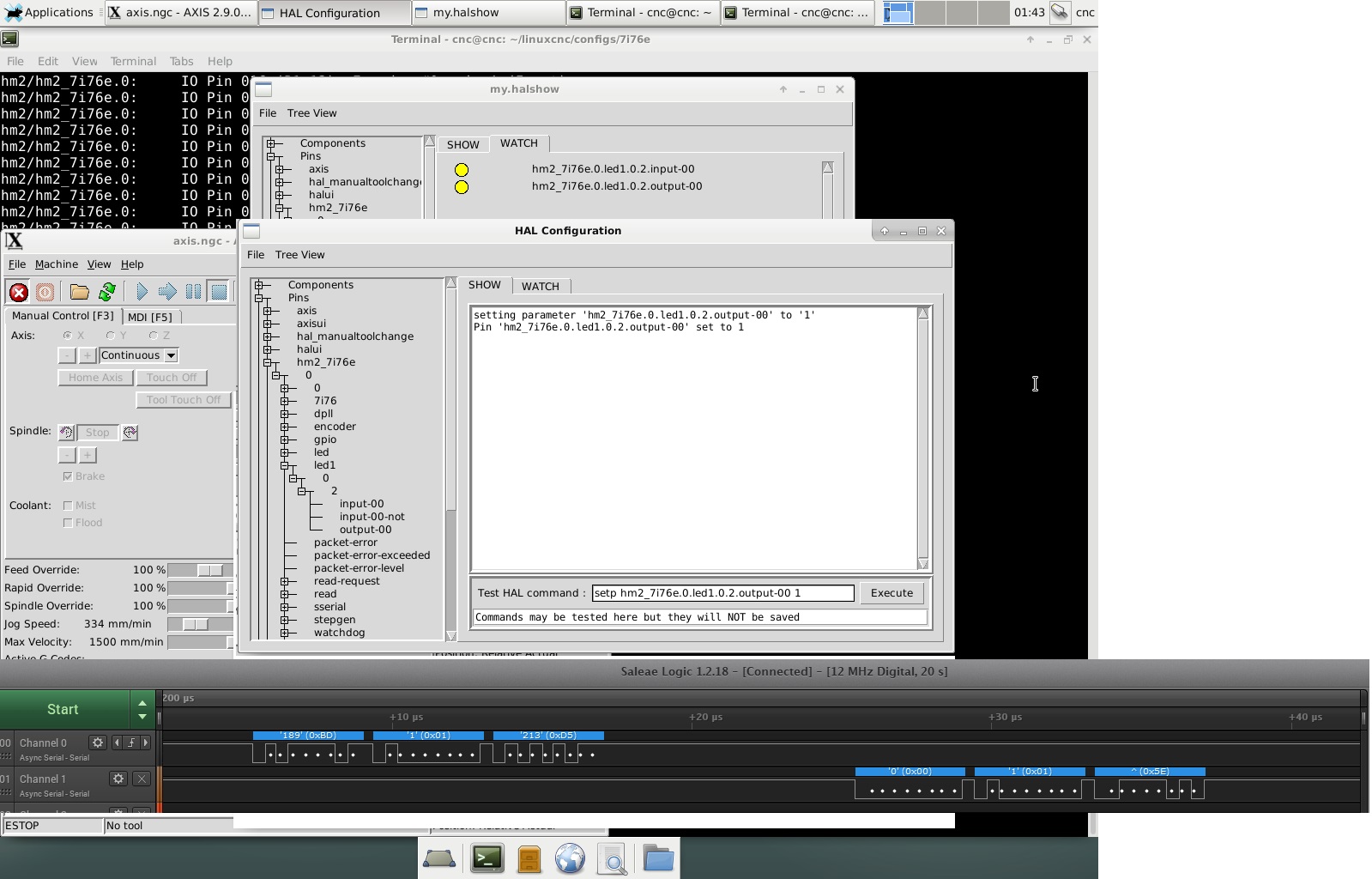

Now it is ok. in case I use sserial not setsserial
I had old LCNC 2.7.15, now it runs on 2.9.0 pre0 (17.3.2021 update to master branch)
I use 7i92 firmware 2x7i76 with one 7i76
here is my definition
LBP_PDD_RECORD_TYPE_NORMAL,.DataSize = 32,.DataType = LBP_PDD_DATA_TYPE_NONVOL_UNSIGNED,.DataDirection = LBP_PDD_DIRECTION_OUTPUT, .ParamMin = 0x0,.ParamMax = 0x0,.ParamAddress = PARAM_BASE_ADDRESS+16,"None\0NVNumber\0"}}
and lcnc create param
u32 RW hm2_7i92.0.cust.0.0.nvnumber
1. I tried to write param to card throught setsserial
halrun
loadrt hostmot
loadrt hm2_eth board_ip="192.168.1.121"
show param hm2_7i92.0.cust.0.0.nv......
loadrt setsserial cmd="set hm2_7i92.0.cust.0.0.nvunitnumber 0x12345678"
comunication is.
0xEC 0x01
0x00
0x65 addr addr 0x43 0x21 crc this is only 16bit
2. I tried set nvnumber in custom_postgui.hal
it is too late because comunication is already in progress
3. set param in cutom.hal
setp hm2_7i92.0.cust.0.0.nvunitnumber 0x87654321
lcnc say....A non-volatile smart-serial parameter has been changed
parameter is set now to 0x87654321. (only when it is different from read value)
comunication
0xEC 0x01
0x00
0x66 addr addr 0x21 0x43 0x65 0x87 crc this is 32bit.
thanks
halrun
loadrt hostmot
comunication is.
0xEC 0x01
0x00
comunication
0xEC 0x01
0x00
thanks
