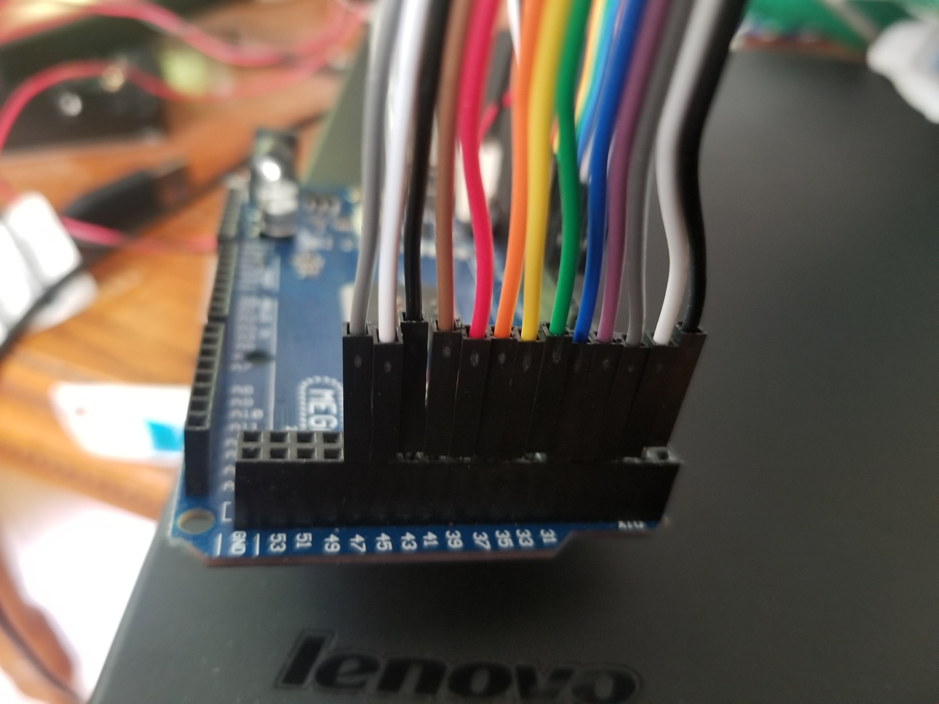

Hello , is any new about this problem ?
This is super idea to use haas keybord panel. Im working on this machine and im satisfied with this panel.
I want to use this or similar keybord panel on my cnc.

What problem are you referring to?
The only problem I'm aware of is finding a keyboard that is cheap enough.

Hello,
thank you for some pictures.
Is the keyboards working similar on the haas system ? or you are using keyboard and some other touchts ?
how looks your home window in EMC for this keyboard ?

As programmed, the keyboard works like a USB keyboard.
I wanted it to work while I booted the computer.
How you use it is up to you and the linuxcnc software you use with it.
Of course you could reprogram the mega to use the keyboard in another way if you like.
