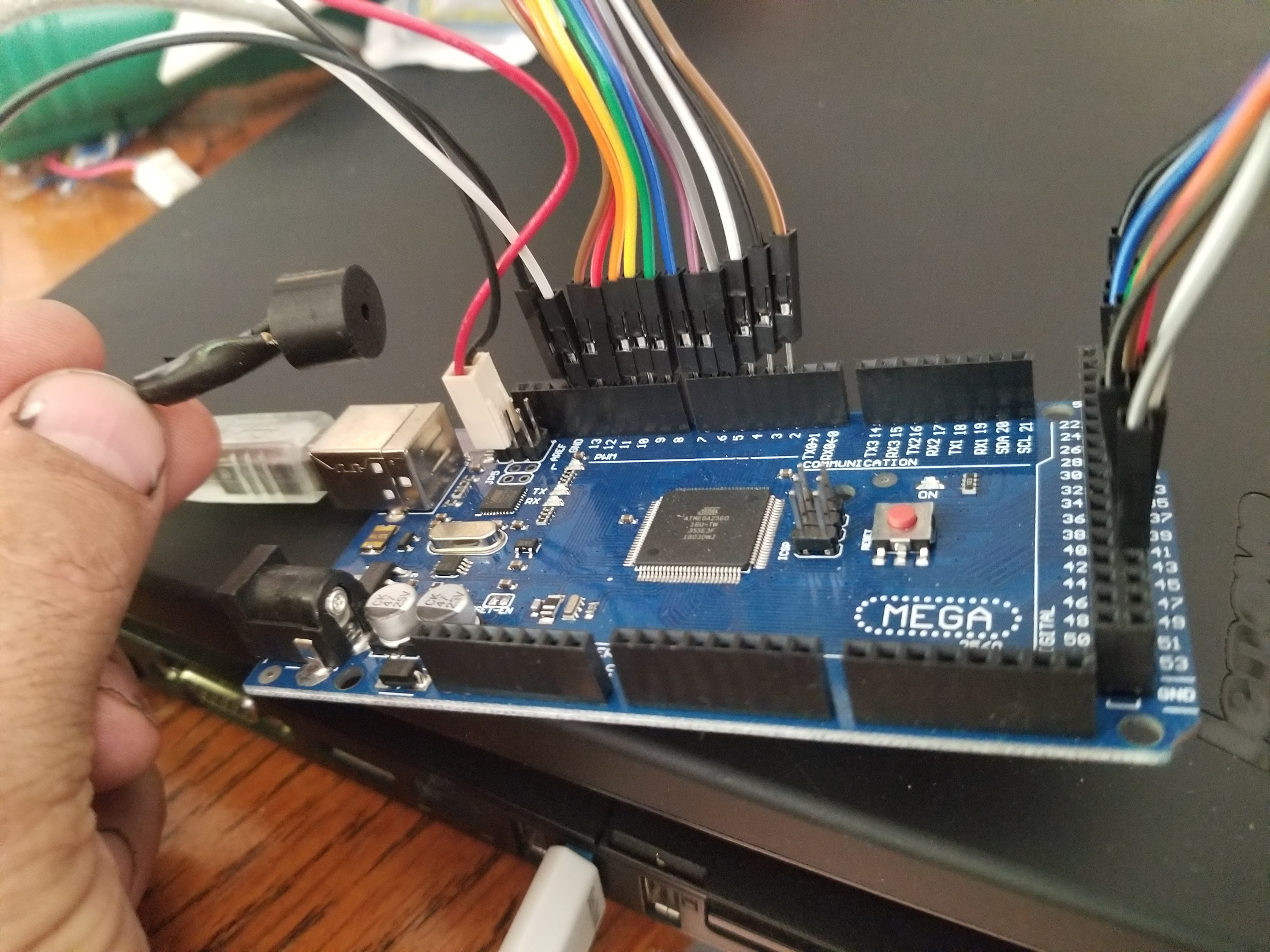

Hello
Ok here is the other pic.
I'm holding a speaker I salvaged from a motherboard.
There is a momentary button out of the picture used to set the mega's USB chip into upload mode.
I have my Haas keyboard running with the Arduino as a USB keyboard.
However, many keys are unassigned.
Is there a way to create Hal pins from a key combination. I imagine CTRL+K --> Hal input --> cooling on for example.
Or is there someone who has a newer version incl. Hal config?
cmorley do you already have a new version?
Or a version with Smart Serial incl. the config for linuxcnc?

I have not got back to anything more with this unfortunately.
you could use hal_input to convert the button presses to HAL pins but then you lose the regular keyboard part.
Yes many keys are not assigned - they need to be filled into the stdKeys or shiftKeys or altKeys array.
I could add another array specifically for cntrl keys too.
I have not git an STM32 running sserial yet (only played a little unsuccessfully then ran out of time).
Chris

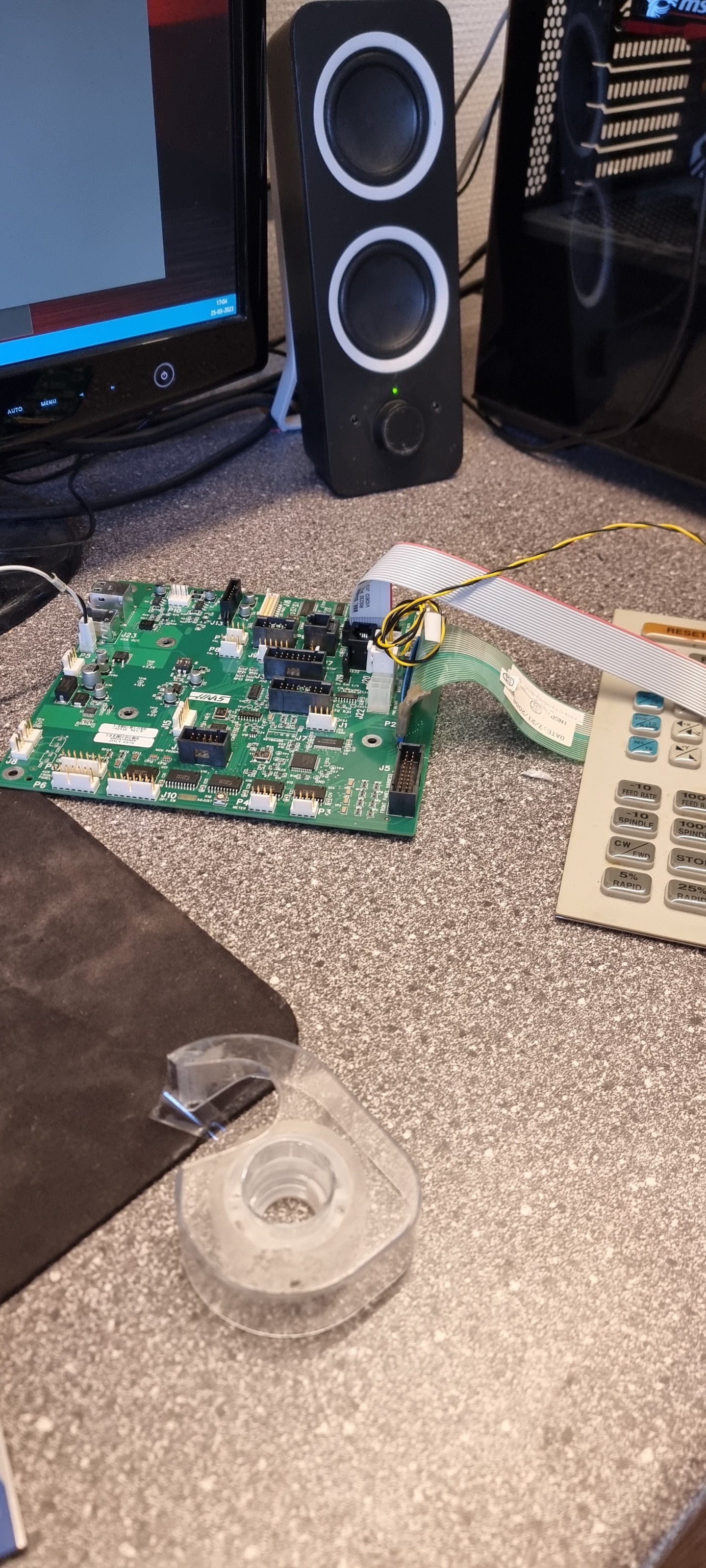

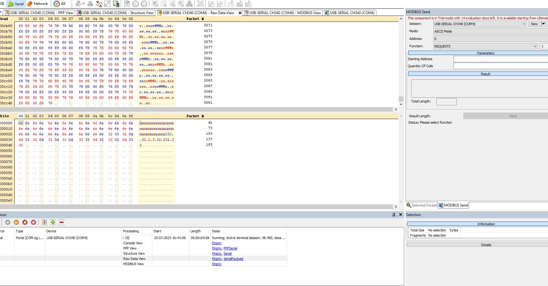

how did it come out with this USB adapter ? i found 2 simulators on the scrapyard, and tried to decode data from the skbif board,

Replied by cmorley on topic USB haas operator panel interface
I don't have a written down map.
I used hass_multiline to print character into a terminal.
With a bit of thoughtful changes it could write out the column and row numbers
Here is the keys I know. each line is a row, each object in the line is a column.
row 1, column 1 is key f6
row 2, column 11 is key Y
The zeros are other currently undefined keys.
(from haas_multi_usb_int)
int stdKeys[ROWS][COLS] = {
{K_F6, 0, 0, K_UP, 0, K_DOWN, K_B, K_H, K_N, K_T, K_Z},
{0, 0, 0, K_HOME, K_LEFT, K_END, K_A, K_G, K_M, K_S, K_Y},
{0, K_F8, 0, 0, 0, 0, K_SHIFT, K_F, K_L, K_R, K_X},
{K_ESC, K_F4, 0, 0, 0, 0, 0, 0, 0, 0, 0},
{K_ESC, K_F3, 0, 0, 0, 0, 0, 0, 0, 0, 0},
{K_ESC, K_F2, 0, 0, 0, 0, 0, 0, 0, 0, 0},
{0, K_F1, 0, 0, 0, 0, 0, 0, 0, 0, 0},
{0, 0, 0, K_PGUP, K_RIGHT, K_PGDN, K_C, K_I, K_O, K_U, K_MNS},
{0, 0, 0, 0, 0, 0, K_D, K_J, K_P, K_V, K_9 + _S},
{K_INSERT, 0, 0, 0, 0, 0, K_E, K_K, K_Q, K_W, K_0 + _S},
{K_TAB, 0, 0, 0, 0, 0, K_7, K_4, K_1, K_COMMA, K_CANCEL},
{K_BSPC, 0, 0, 0, 0, 0, K_8, K_5, K_2, K_0, K_SPACE},
{K_ESC, 0, 0, 0, 0, 0, K_9, K_6, K_3, K_PERIOD, K_ENTER},
if you look carefully at the pics on page 3 you should be able to figure out the wiring.
One pic shows the ribbon with two groups of wires.
one starts with a black wire and ends with a gray wire.
one starts with a brown wire and ends with a brown wire.
black to gray is for megas's pins 23 to 47
brown to brown is for pins 2-12
Chris
