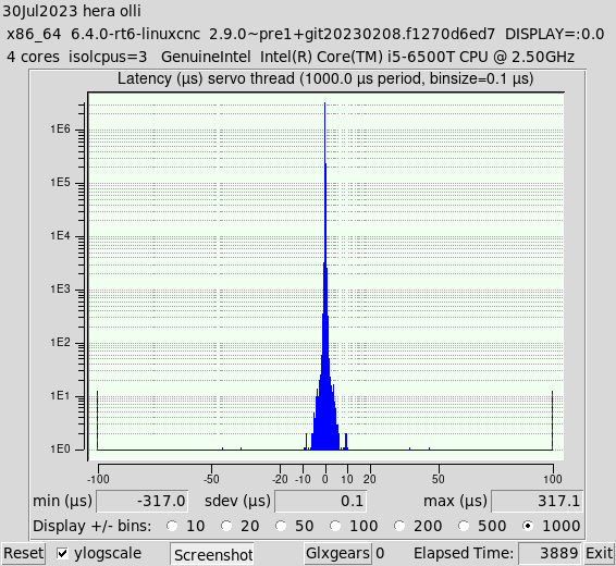

30 Jul 2023 12:24 #276563
by WKS-3D
Replied by WKS-3D on topic Neue Hardware und schlechter Latency Test
This is the latency test ~1h
This is the PING-Result from the Mesa-Card (7i92TM)

30 Jul 2023 12:33 #276565
by WKS-3D
but in Probe Basic Lathe after a short time a window opens with the message:
I have now actually done everything that was described to me above
Unexpected realtime delay on task
0 with period 100000
This Message
will only display once per
session.
Run the Latency Test and
resolve before continuing.I have now actually done everything that was described to me above
- Posts: 21959
- Thank you received: 7478
30 Jul 2023 12:48 #276566
Replied by tommylight on topic Neue Hardware und schlechter Latency Test
Ping is OK, latency is not OK.
Hold down SHIFT button after power on, choose "advanced options ..... " see if you can choose the 6.1 kernel and try latency test again.
