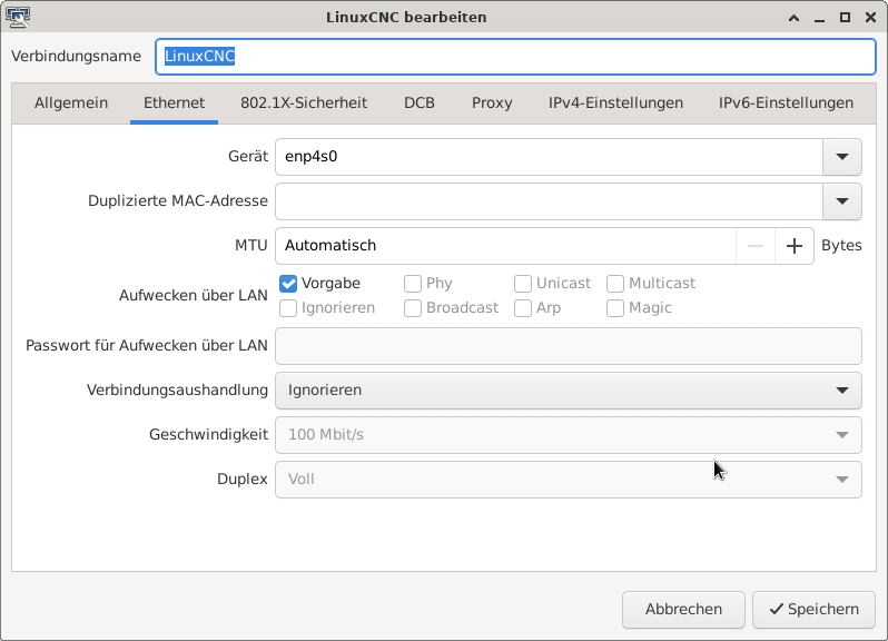

05 Aug 2023 08:20 #276979 by WKS-3D
Replied by WKS-3D on topic Neue Hardware und schlechter Latency Test
Sure you have the correct device?
05 Aug 2023 10:01 #276983 by tommylight
Replied by tommylight on topic Neue Hardware und schlechter Latency Test
Do not create a new connection, edit the existing one.
Linux is very good at having several network connections on a single ethernet port, and that may cause issues when using internet browsers while the machine is on.
  • WKS-3D
  • WKS-3D's Avatar Topic Author
  • Offline
  • Premium Member
  • Premium Member
05 Aug 2023 10:36 #276986 by WKS-3D
I have 2 connections:
1. enp3s0 (home network)
2. enp4s0 (for the mesa card)
The only thing I have configured on the connections is the name and IP address.
Should I do something different?
05 Aug 2023 11:29 #276992 by tommylight
All good, changing the name of the existing connection is OK.
While at it, disable IPV6 for the LinuxCNC connection, set IPV4 to manual and type the IP.

05 Aug 2023 12:54 #277000 by rodw
Can you share the output from typing: ip a
The screen dump is not terribly useful so we still don't know how you have set up your Network interfaces.
I recommend you follow the docs
linuxcnc.org/docs/2.9/html/getting-start...s_only_for_mesa_card

05 Aug 2023 13:48 #277004 by WKS-3D
ip a
1: lo: <LOOPBACK,UP,LOWER_UP> mtu 65536 qdisc noqueue state UNKNOWN group default qlen 1000
    link/loopback 00:00:00:00:00:00 brd 00:00:00:00:00:00
    inet 127.0.0.1/8 scope host lo
       valid_lft forever preferred_lft forever
    inet6 ::1/128 scope host noprefixroute
2: enp3s0: <BROADCAST,MULTICAST,UP,LOWER_UP> mtu 1500 qdisc fq_codel state UP group default qlen 1000
    link/ether 50:9a:4c:18:57:03 brd ff:ff:ff:ff:ff:ff
    inet 192.168.0.131/24 brd 192.168.0.255 scope global noprefixroute enp3s0
3: enp4s0: <NO-CARRIER,BROADCAST,MULTICAST,UP> mtu 1500 qdisc fq_codel state DOWN group default qlen 1000
    link/ether 68:05:ca:3f:98:31 brd ff:ff:ff:ff:ff:ff
    inet 10.10.10.1/8 brd 10.255.255.255 scope global enp4s0
I have done all the steps from the link. :)
