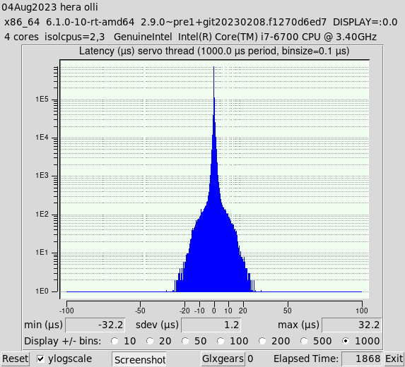

So, new hardware arrived and I reinstalled everything.
Here are the current latency values: (During the test, YouTube videos were playing and I was surfing the net.)
and the PING results:

Is this ok or can it be better?
I have worked through the instructions.
Last edit: 04 Aug 2023 16:19 by WKS-3D.
04 Aug 2023 16:35 #276910 by PCW
If the PC has a Intel MAC, you should disable IRQ coalescing
as described in the hm2_eth manual page
(and verify that its off with ethtool -c eno1)
replace eno1 with your ethernet device name if its different
04 Aug 2023 16:40 #276912 by tommylight
Replied by tommylight on topic Neue Hardware und schlechter Latency Test
It looks fine.
Did you test without isolcpu ? I really hate knee-capping hardware without a really good reason, so i never used it.

04 Aug 2023 17:02 - 04 Aug 2023 17:05 #276914 by WKS-3D
Replied by WKS-3D on topic Neue Hardware und schlechter Latency Test
Is that what you mean?

It looks fine.
No I have not. Should I do that?
