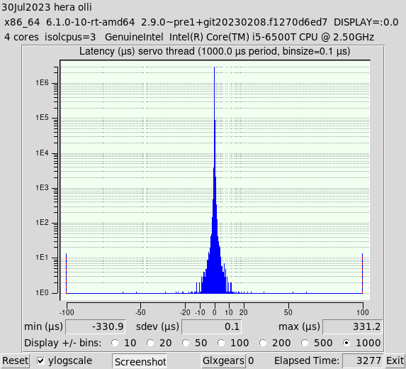

30 Jul 2023 19:26 #276576 by WKS-3D
Replied by WKS-3D on topic Neue Hardware und schlechter Latency Test
Ping is OK, latency is not OK.
Hold down SHIFT button after power on, choose "advanced options ..... " see if you can choose the 6.1 kernel and try latency test again.
It has not gotten better with the 6.1 kernel.
Then I should try the XANMOD, or is there something against it?

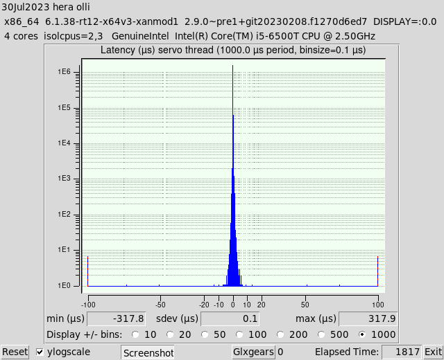

30 Jul 2023 20:36 #276579 by WKS-3D

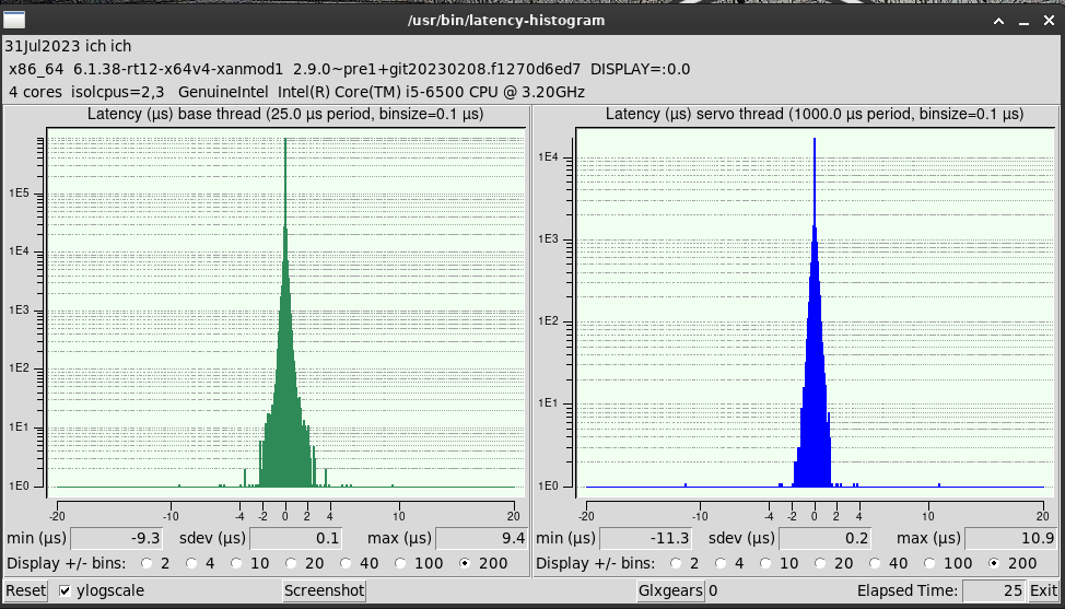

I tried the XANMOD and at first it looked like it was the solution, but after 20 minutes the max latency went up.
Any other suggestions on what I can try?

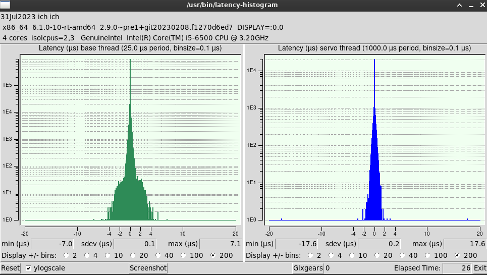

Please revert to the default Bookworm 6.1 kernel. As Tommy said, you can probably select it from the GRUB menu as it should still be on your PC. It was perfectly OK, Xanmod kernel and 6.4 was just a time wasting distraction.
The latency of the 6.1 kernel I have already posted above, but I have now done everything according to the instructions and this is the result.
I suspect that something is wrong with the hardware.

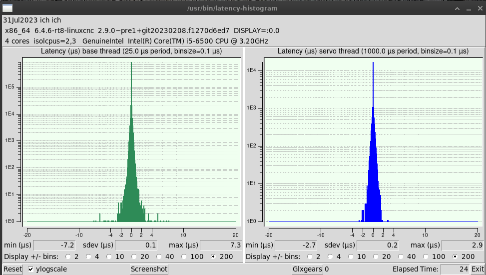

I wouldn't say so. Of course the 6.1. kernel not bad but what I'm observing is the Xanmod and 6.4. Just better. I don't observe any big spikes there and the latency to the mesa card is better. And how it behaves with problematic hardware should always be tried out.
My test is very simple.
Start latency test -> open browser and start forum page
Start linuxcnc -> start big file
The spikes usually appear when the browser is started or when large files are opened.
6.1.
Xanmod
6.4.
My result: Xanmod or the 6.4. kernel is better than 6.1.
