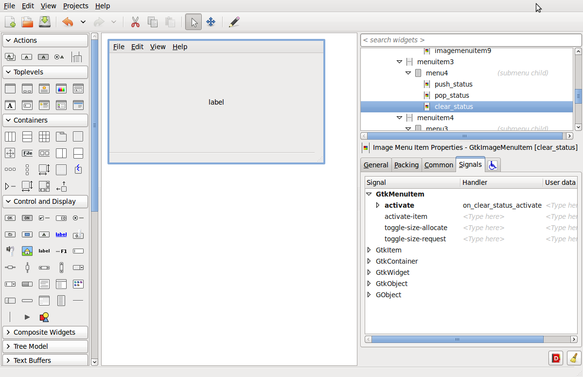

Hi:
I have installed LinuxCNC 2.5.3. I have not installed pyngcgui.
I have some errors when trying the Glade3 tutorial and finished tutorial 1 and 2. I have redone glade3 tutorial lesson and repeated the errors.. I have attached the screens showing my input matches the tutorial instructions and the glade3.py.
The Terminal error message is:
bob@probotix-desktop:~/glade_tutorial$ python glade3.py
glade3.py:11: RuntimeWarning: missing handler 'on_clear_status_activate'
self.builder.connect_signals(self)
Even with the error the glade3.py screen show up. I click view and see the message count increase when Push Status is clicked; Pop Status decreased when clicked and Clear Status does not do anything.
Thanks for your help,
Bon

Your missing the on_clear_status_activate function from part b of the tutorial. And I see how you missed it... it is not in the all together part of the py.
Edit: the web page has been corrected.
