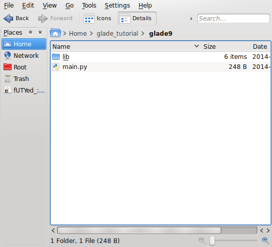

I did 9a and 9b OK. I add a sub folder, lib and put all but main.py in it. In main.py I substituted "import lib.myclass as mc" for "import myclass as mc" and ran main.py. It produced the errors:
bob@probotix-desktop:~/glade_tutorial/glade9$ ./main.py
File "./main.py", line 3, in <module>
ImportError: No module named lib.myclass <<<<<<<<<<<<< error
Main.py worked before theaddition of lib and putting the files in it.
Bob

- BigJohnT
- Posts: 6999
- Thank you received: 1176
11 Feb 2014 20:58 #43750
by BigJohnT
That was a typo and I've fixed that... glad to know someone is using the tutorials.
JT

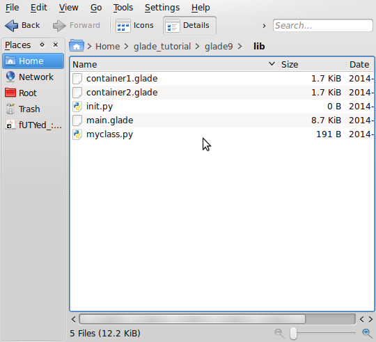

- rggrieger
- Posts: 32
12 Feb 2014 05:37 #43777
by rggrieger
Replied by rggrieger on topic Glade3 Gtk Python Tutorial Errors
Hi John:
I redid 9a and b and the error is still there. It works with main.py and myclass in the same directory but not with myclass in the lib directory. What is you fixed so I can look to see if it is indeed in 9a or b.
bob@probotix-desktop:~/glade_tutorial/glade9$ chmod +x main.py
bob@probotix-desktop:~/glade_tutorial/glade9$ python main.py
This is what I want to print
File "main.py", line 3, in <module>
ImportError: No module named lib.myclass <<<<<<<<<<< Error
Bob

- BigJohnT
- Posts: 6999
12 Feb 2014 06:02 #43778
by BigJohnT
Replied by BigJohnT on topic Glade3 Gtk Python Tutorial Errors
Aww carp, asciidoc changed my _ to make the word in italics...
You have to have an empty file named __init__.py in the same directory as the libraries. Note that is two underscores before and after init.
JT
JT
- rggrieger
- Posts: 32
12 Feb 2014 06:18 #43780
by rggrieger
Hi JT:
Renaming the empty file to __init__.py worked!
Part 9e has a broken link for "gtk combobox". I googled it and found a lengthy turorial, 2005, www.pygtk.org/pygtk2tutorial/index.html Ch 16 is on combobox. The tutorial is for Gtk v 2.0 and I can not find the gtk version used for the Glade 3 tutorial.
Bob
Bob
