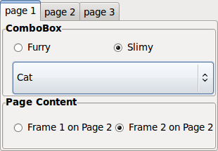

I did 9f and the dialog box appears but only the Fuuy selection works. The Slimy retains the Furry choices. I can not see the bottom links do anything.
