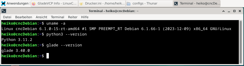

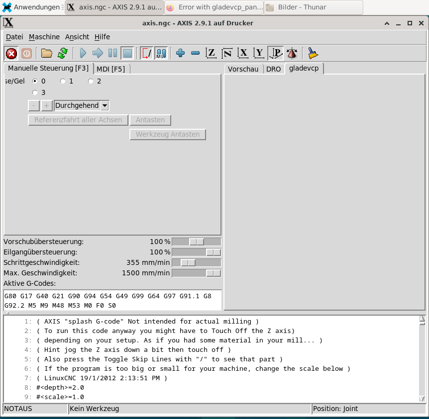

I updated my linuxcnc machine to version 2.9.1 using the linuxcnc_2.9.1-amd64.hybrid.iso
After the update the gladevcp panel did not work anymore, well they didn't look nice anyway so I decided to build new once from scratch.
That didn't work either. The panels are just blank. I don't think there is an error message. At least I can not find anything that gives me a hint on what I'm doing wrong.
versions
test run
in axis

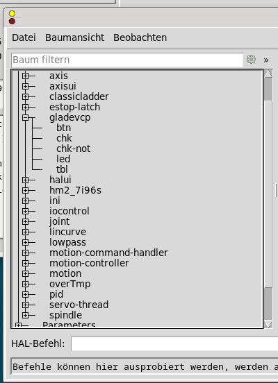

pins are created
attached: terminal report; ini; ui

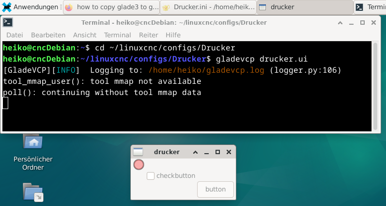

I'm working on an existing configuration, that's why I immediately thought that there is something missing that is coming with a new configuration.
So I made a new config using Pncconf wizard. Even made a new glade test panel.
This time I got an different error: 'gi.repository.Gtk' object has no attribute 'glade'
Again I have no idea why I get this error. Any info regarding that is appreciated.
Well I have one question regarding this. In the documentation it is mentioned that the ui file need to be saved as GtkBuilder file.
I didn't find anything to select when both saving and save as. Is this still something to take care of?

than you for helping me solving this issue.
I still don't know what hitcounter.py really does. At least it does not change anything if it is there or not.
Is this thought to be a template to be used for glade panels?
The 'gi.repository.Gtk' object has no attribute 'glade' error was an typo - wrong ui file name - sorry for that.
Finally the test configuration was working and the glade panel did show up. Then I copied the panel which was not working into this configuration and even that showed up.
Conclusion something must be wrong in my "sharp" machine configuration.
Somehow CYCLE_TIME was set to 1. Glade does not seem to like that. Set that back to 100 and the glade panel showed up again.
