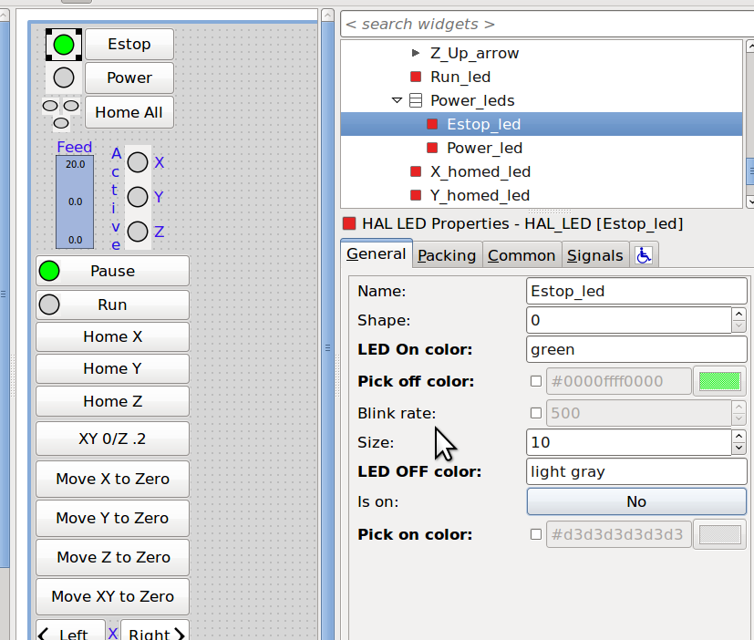

also, i have a gladevcp.Estop_led connected to a gladevcp hal_toggle button
in my posthal.hal halui.estop.is-activated.
in glade;
is on = no
LED on color = green
LED off color = light gray
LED is green in glade panel
in axis;
start led is green
clicked turns to light gray
power btn is disabled till i click estop.
so in glade it's off(suppose to be light gray)
in axis it's works as it should(starts off- light gray)
kenneth
if i change the colors to opposite, it changes to work correctly.(but opposite in glade)

i think i have what estop does backwards. it's on when axis starts ?
i was thinking it was off.
kenneth
kenneth
- psha
- Posts: 99
20 Sep 2011 03:56 #13322
by psha
Replied by psha on topic Re:GladeVCP
Yes, estop (software) is active when EMC starts. If you have hardware button it may be different.
