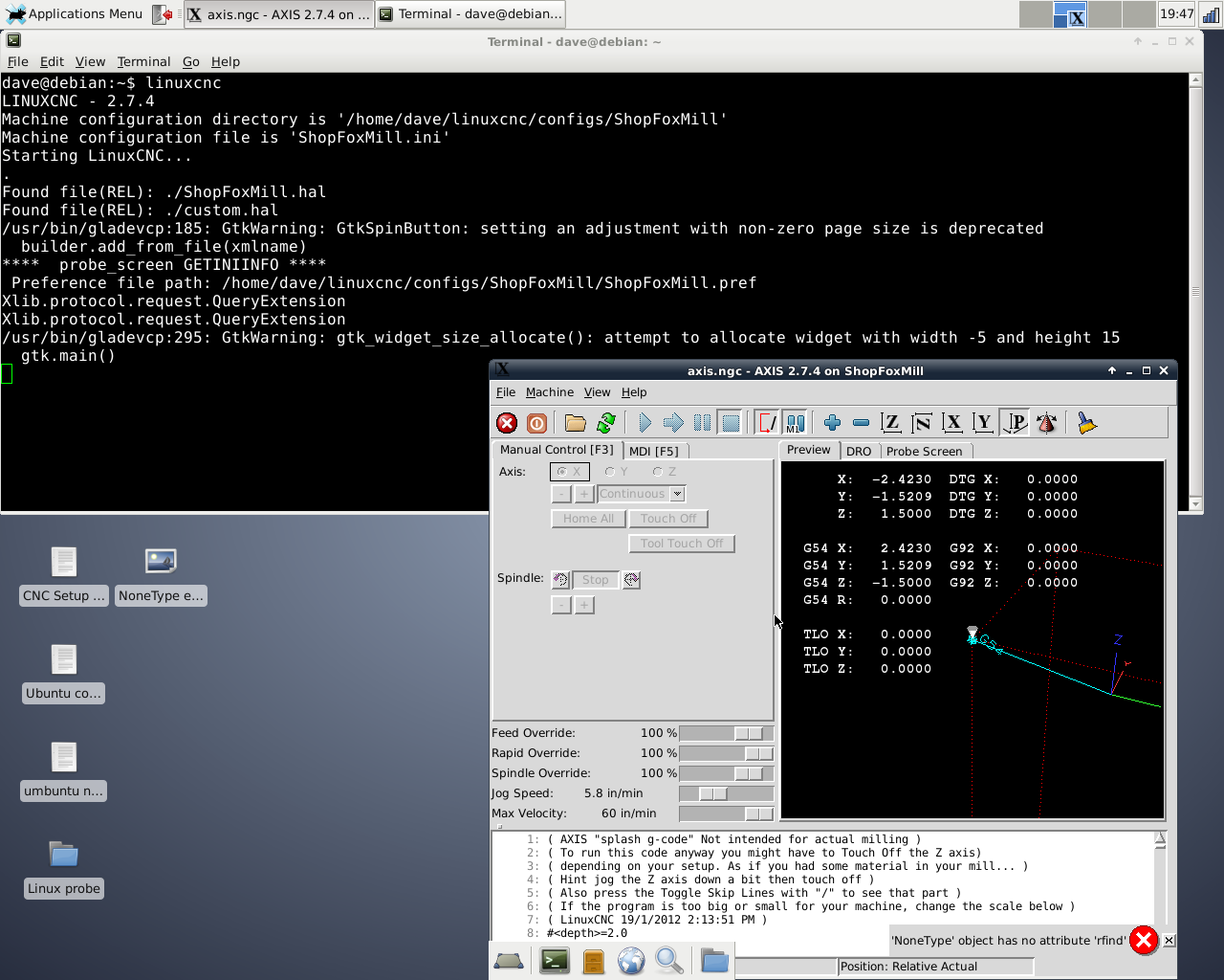

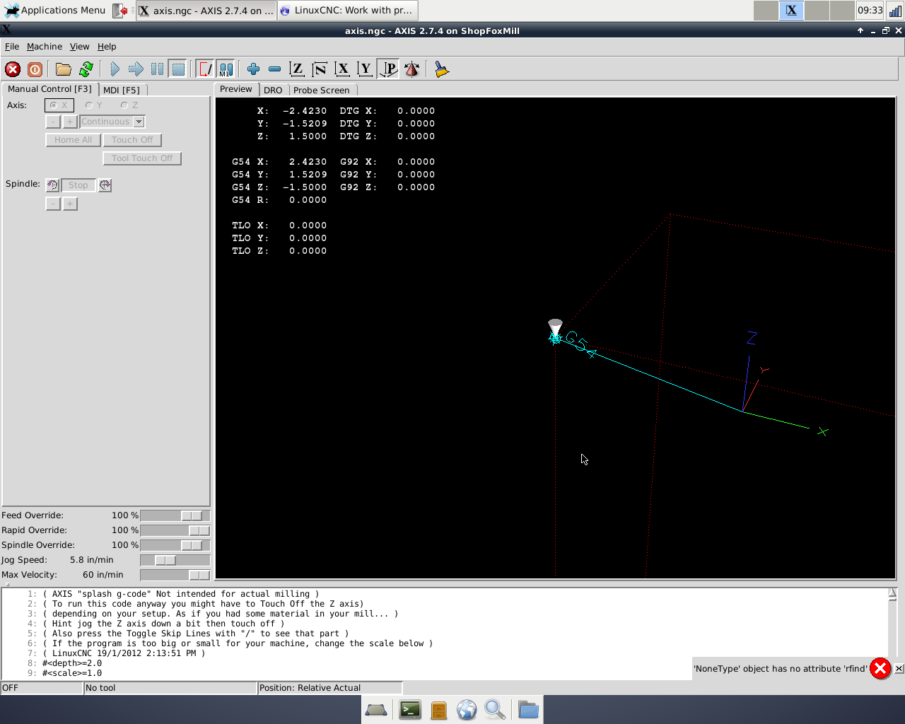

- Posts: 55
18 Mar 2016 04:20 - 19 Mar 2016 17:52 #71846
by gizmo6023
Replied by gizmo6023 on topic Installing Work with probe
Thank you for the help Verser.
I now get the probe screen but also get an error 'NoneType' object has no attribute 'rfind'
I canceled the error and attempted to run the probing routine ( no probe installed to be safe) and get numerous "Unable to open file" errors . Pressing probe down generates no move and Error: Unable to open file <down>, pressing X- moves the spindle down and generates Error: Unable to open file <xminus>, pressing X-Y- out moves the table - and spindle down and generates Error: Unable to open file <xminus>
Seems the program gets lost before the last rapid move is called, just before the measurement routine should start.
I have attached my .ini .hal and output from dmesg and a couple of screen shots, perhaps this information will help diagnose the reason for this behavior.

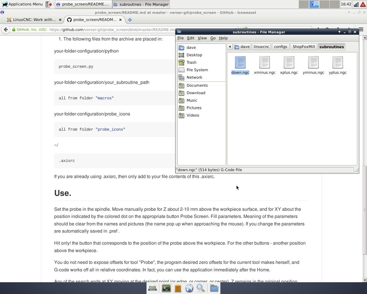

21 Mar 2016 13:27 #71983
by verser
Replied by verser on topic Installing Work with probe

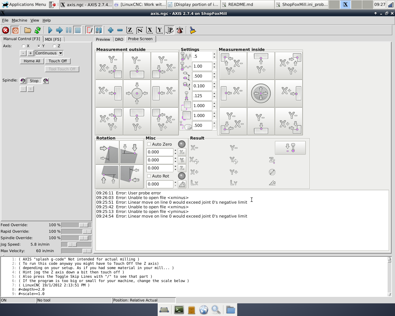

Please show me the look of a full path to the down.ngc on your computer.Pressing probe down generates no move and Error: Unable to open file <down>
- gizmo6023
- Posts: 55
22 Mar 2016 00:03 #72001
by gizmo6023
Here is a screen capture showing the location of the down.ngc
If I am reading this file structure properly it is Home/dave/linuxcnc/configs/ShopFoxMill/subroutines
Second screen shot shows errors produced for pressing Y- X- Y+ X+ all produced a move of the head toward the table then an error.
Pressing probe down produces error with no head movement. Pressing cylinder produced head down table left moves then error.
