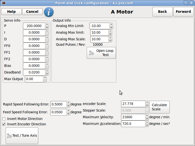

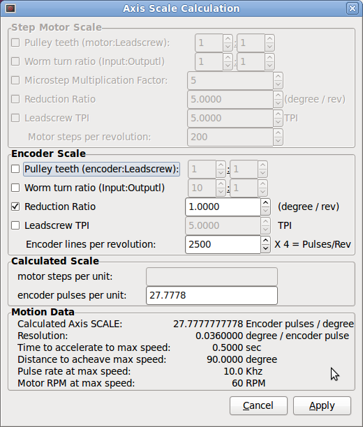

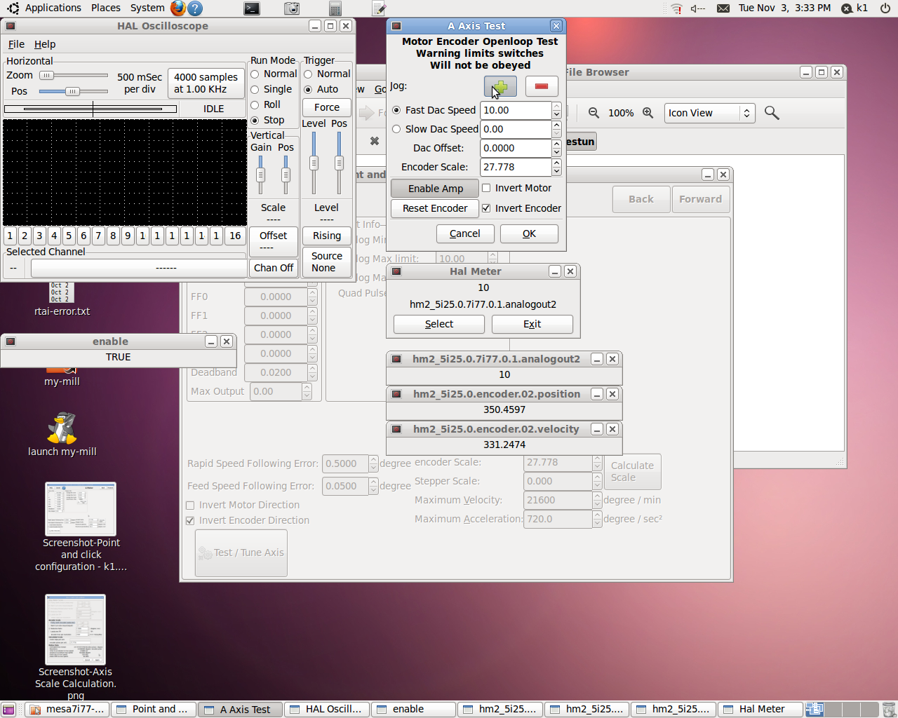

I study the BingJonT tutorial about pid tuning .... so I know the number of encoder pulse for 1rpm and other basic information ..... at the start of these thread I not Know some problem about my driver configuration .... customer setting acc and dec ramp to 0 as standard .... but these create the little offset that I asked before .... now I'm able to stay blok my motor and jog it with pnconfig function, encoder inverse and all work at right direction .... (some image)
and result ini file (NOTE OLY AXIS 3=a IS CONFIGURATED... I'M IN TRIAL TEST)
File Attachment:
File Name: k1.ini
File Size:4 KB
At 10V reference motor make 60rpm as described in pnconfig ..... but when start axis and try to move (in jog) A axis I receive follow error axis ..... someone has suggest??
Regards
Giorgio
Last edit: 03 Nov 2015 22:49 by bkt.
03 Nov 2015 23:32 #64707 by PCW
Replied by PCW on topic servo dac offset
I would set the following errors _MUCH_ wider, say 10 degrees so you can see whats going on,
with a .05 degree following error limit you cannot tell if the system runs away (backwards feedback)
or you just dont have tuning good enough

Openloop test in pncconf the only thing it does is send out the analog signal set .... I guess it's true ?
04 Nov 2015 00:22 #64710 by PCW
LinuxCNC will also of course also send out analog signals if setup properly
Do you get any motion with LinuxCNC?
Are the drives enabled when Linuxcnc is running? (out of ESTOP and in machine-on state)

04 Nov 2015 00:33 - 04 Nov 2015 00:56 #64714 by bkt
Replied by bkt on topic servo dac offset
Yes, when run drive go enable .... and with a wrong config the follow error come out after a little step of motor ....
hm2_encoder.02.velocity It must correspond to the motor speed ? Because in these case when motor at 10V go to 50rpm these param hm2_encoder.02.velocity go to 299/300 .... is normal these?
Regards
Giorgio
Last edit: 04 Nov 2015 00:56 by bkt.
04 Nov 2015 00:52 #64721 by PCW
This is why you need to set the following errors wider so you can see whats going on
The following user(s) said Thank You: bkt

04 Nov 2015 00:59 #64724 by bkt
Yes is normal ...... from www.linuxcnc.org/docs/html/man/man9/hostmot2.9.html ...... " (float out) velocity Estimated encoder velocity in position units per second." ...... 50rpm = 0.83333 spsec = 300°/sec (degree is my unity) .....
